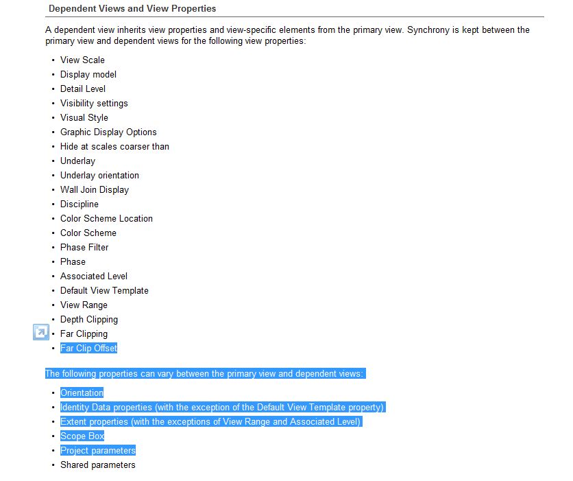

I used to think they are identical, just the crop may not be the same. Recently I found at least when you hide one object by right click and hide it only happen in one view, it's not shared between parent view and dependent view. I remember noticing some other inconsistency but slip out of my mind now. What are really shared or not shared between parent view and dependant view?

Here's an image from the help menu that should answer your question.
