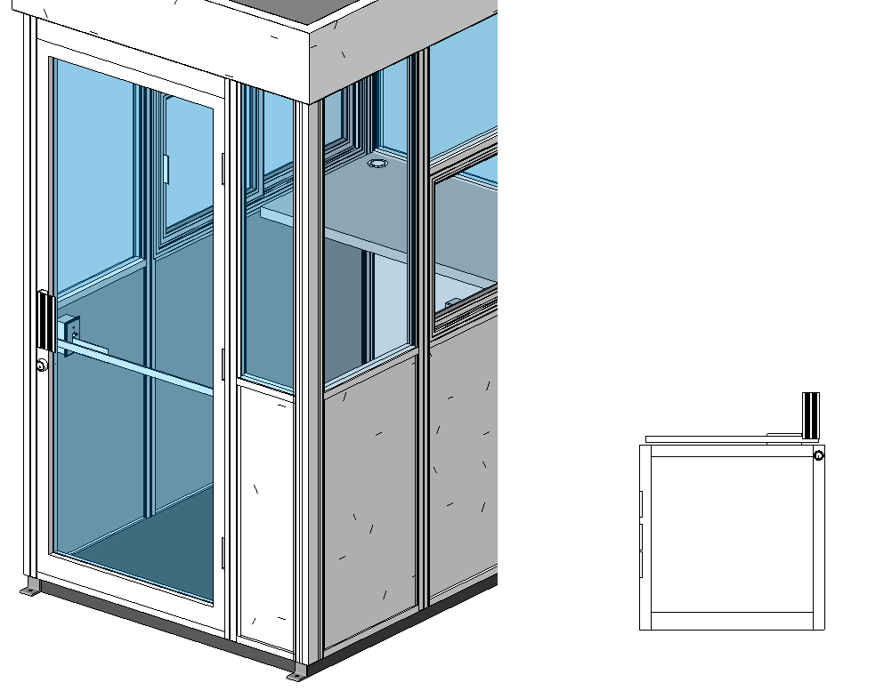

I've read a bunch of forums about curtain wall doors but can't an answer to my dilema.
 I've modeled a beatiful curtain wall door that works perfect, it adjusts to the right size and it can be tagged as a door no problem. However, when I put it into my legend as a legend component, it puts it in at a funny size. I've attached a image showing my 3D modeled along with how it shows up in the legend. Currently I just show it as 2D lines to 'workaround' it but that seems inefficient. Thanks!
Mon, Nov 29, 2010 at 8:56:39 AM | Curtain Wall Door as Legend Components
Curtain wall panels are always shown in a legend as a square panel.  You can change to host legth to something like 8' and you will have an 8 x 8 door.... Not what you wanted - right?
We usually use a model elevation view rather than a legend.  Then we hide the elevation call-out on allplan views.
You could also export to CAD to freeze it to a 2D view, then import that linework into your legend.

I have the 'Freeze drawing' add-in so I'll just use that for the lines. Thanks for the response.
