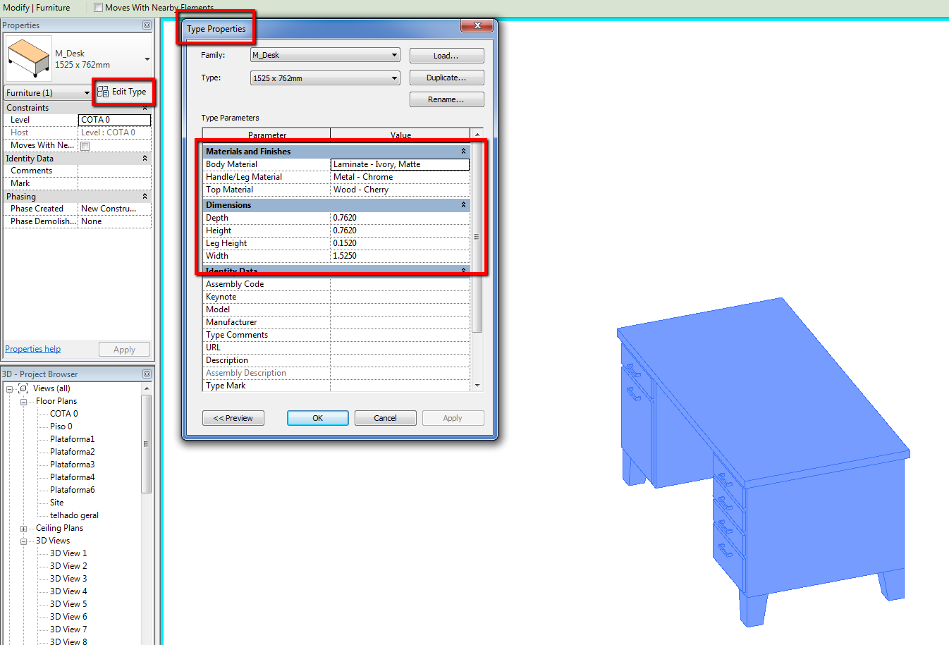

Id like to change the size of a table that I downloaded from this site. I cant edit type or use the scalign tool, the scaling tool is greyed out and theres no section under type to change the dimensions.

It all depends how the family was created, if the family was created in Revit (parametric) you don't need to "Scale" anything, just select the "Table" go to properties, if you don't see any dimension in instance go to "Edit Type" and check if you don't have parameters like "Material and Dimensions" to change, if the family was created in Autocad, Sketchup or other software you need to edit that family and scale inside the family.

Yeah, there were no dimensions in type. Ill try editing the family. Thanks for the info.
