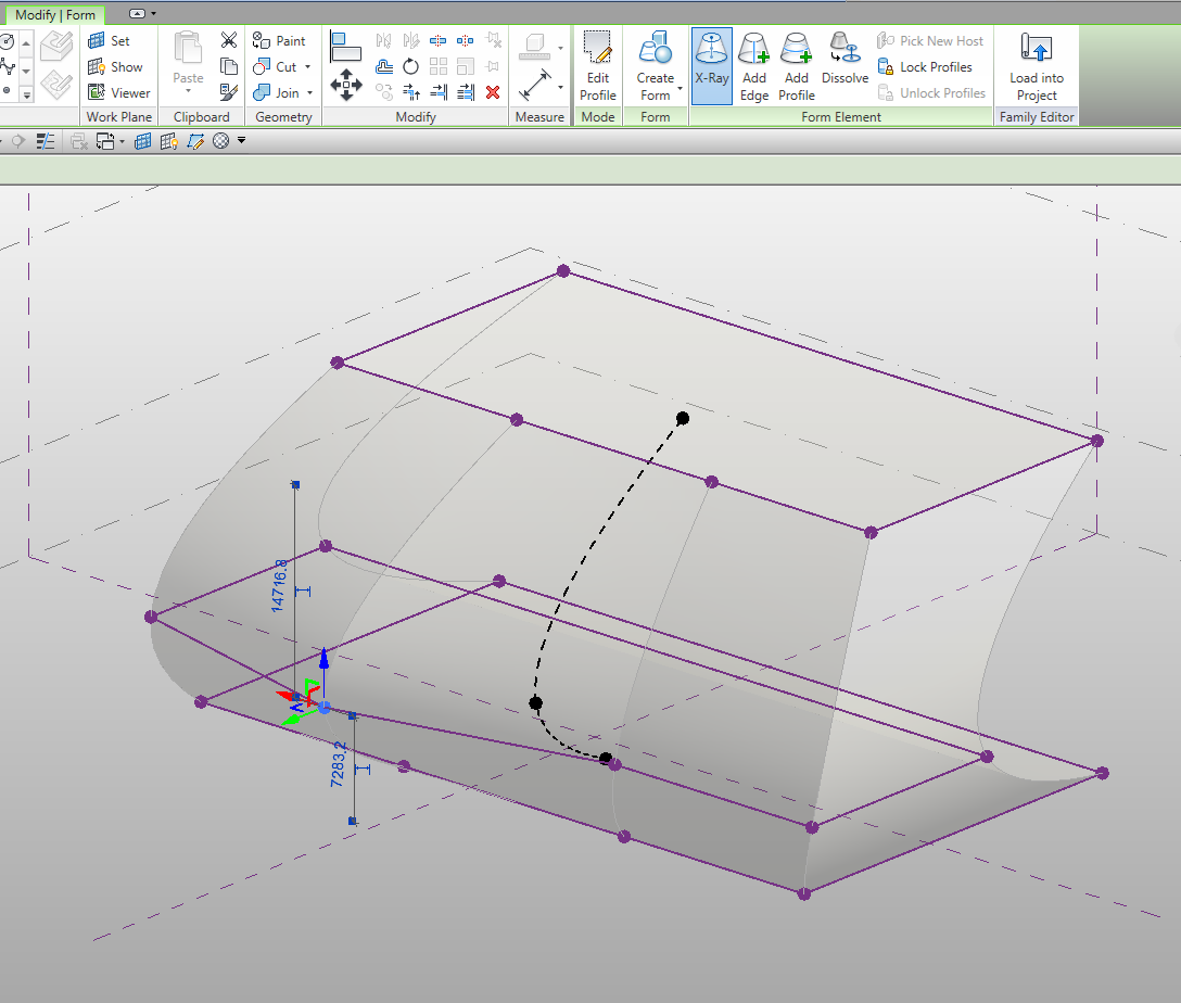

here's my problem (image)
it happens often while massing... No option to edit one axis.
also - too many temporary dimensions :/

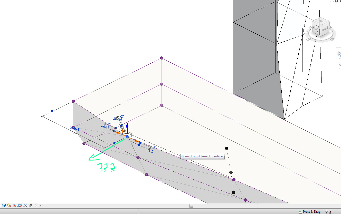

When you are in that situation click in your "SPACE" bar, the gizmo will change like you want.

wow thanks a lot
and what actually *is* this second gizmo?
