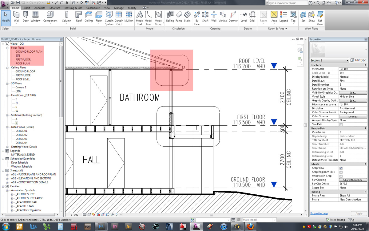

Hey guys,
This is my fisrt post. I'm a CAD user coming across to revit and a couple of things are driving me nuts.
1. Why are my Callout heads missing i think i deleted them from the project browser and for the life of me cant get them back.
2. (minor problem) I want my floor plans in the project browser to read:
SITE
GROUND FLOOR
FIRST FLOOR
ROOF
See image.
Any suggestions would be great,
Cheers

1. Select that callout and go to the properties.
2. In project browser, put your mouse over those names, right click and "Rename" like you want.

Thanks for the reply,
I fixed the first problem. Manage Tab> Additional Settings> Callout Tags> had callout head set to <none>
Don't know how this happened but and embaressingly easy fix (once figured out).
With the second prob,
I dont want to change the name of the views, just the order. I assume it has something to do with Browser Organization Properties.
Seriously though, wouldn't it just make more sense if you could just drag and drop these in the order you want.
