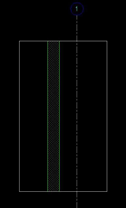

The first picture is of the standard CMU crosshatch for CMU in section.

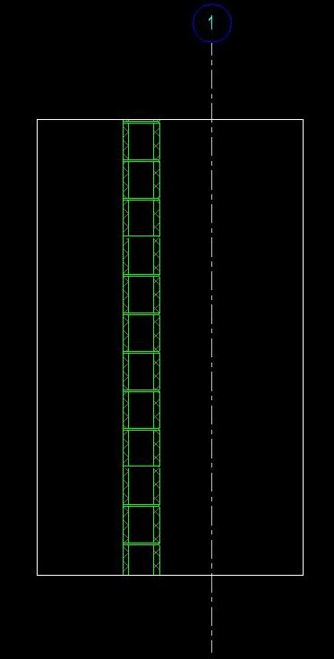

The second picture is the desired look of the CMU in section for my firm.  I used a repeating detail of the CMU detail component.

Ok, so the way that I would do this is to first shut off wall visiblity or at least make the cut pattern not visible in section for the wall, then go in and modify your detail component.  In there it looks like you have 2 or 3 filled regions/masking regions.  All you should need to do is delete what ever is masking the wall in the center, and make the outer hatchings transparent if they are not already.
Hope that makes sense...let me know if it doesn't.   If not...post up your detail component and I will take a look and fix it.

That is what he is doing, but the detail is covering up his bars, so he needs to change the detail component so that it does not cover his bars.

Thanks gdoherty, that is a simple and effective solution.
Using the repeating detail is nice, but I have to do it for every section cut through a CMU wall.  It would be great if I could make the repeating detail into a fill pattern type and assign it to my cut pattern for CMU walls.  However the fill pattern would have to recognize the bottom corner of the CMU wall as the start point for the pattern to make sure masonry coursing is shown correctly.  Do you think this is possible?
