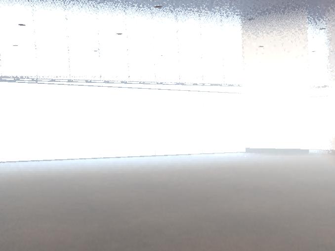

I am trying to utilize the rendering of Revit, but when I do interior view with the defaul Interior:  Sun and artificial, I get massive over exposure of sun.  I changed the background to be sky:cloudy too.  I would like to see out of the building without getting the massive glare.  How do I do that?

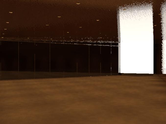

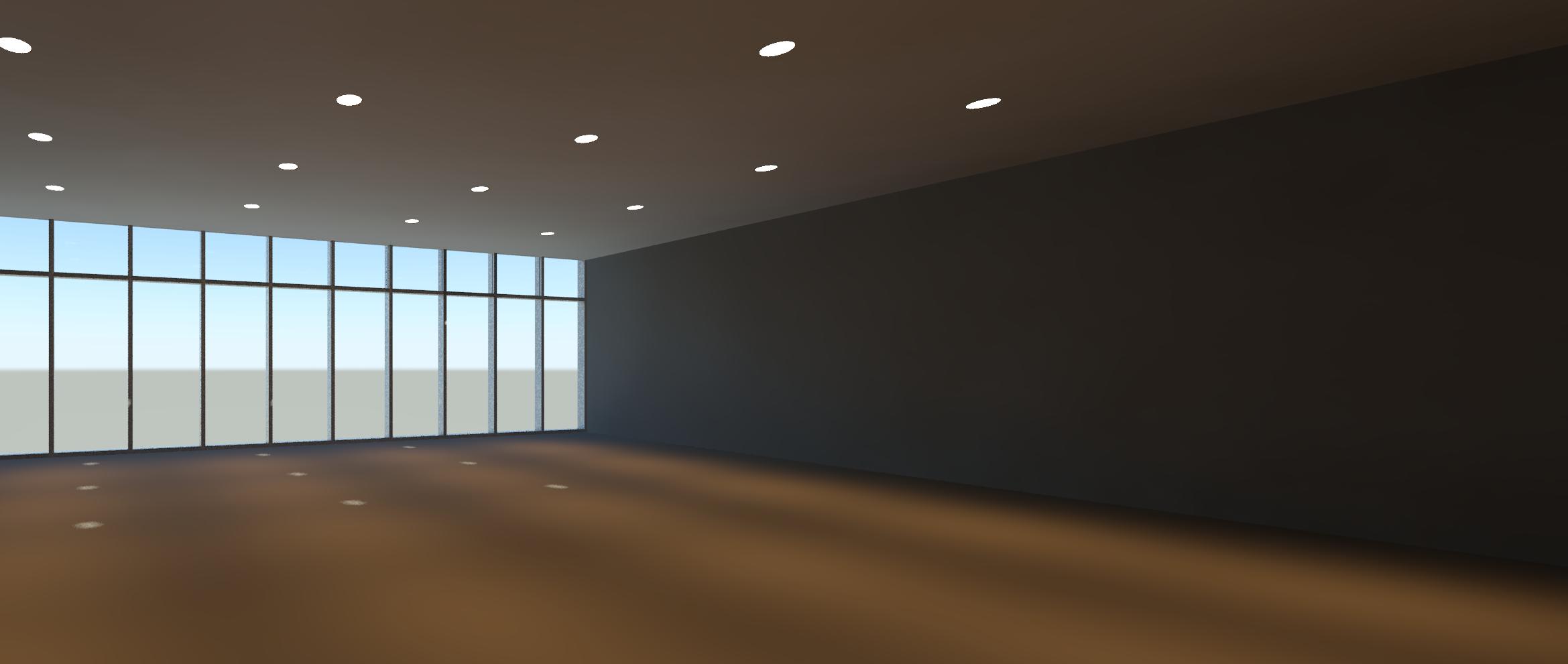

Reverse problem:  I changed the location settings to be at 7:30 pm in May in Atlanta, GA so that I could get an exterior view of the building with its lights on inside.  This is what I got.  Why is the outside all black?  And why isn't the artificial lights so dim?  As you can see from the other image, I have plenty of artificial light. Edited on: Fri, Nov 19, 2010 at 5:57:43 PM

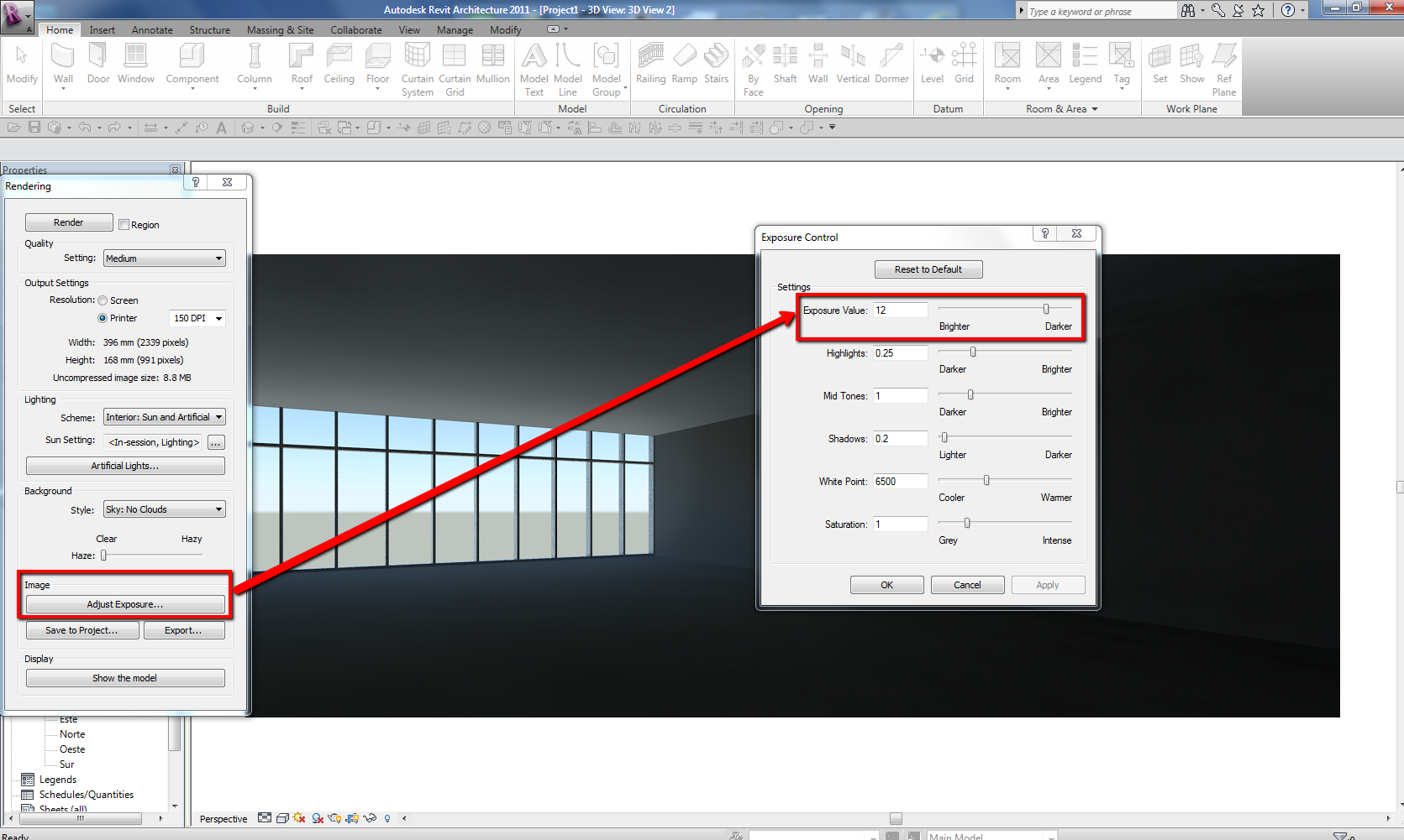

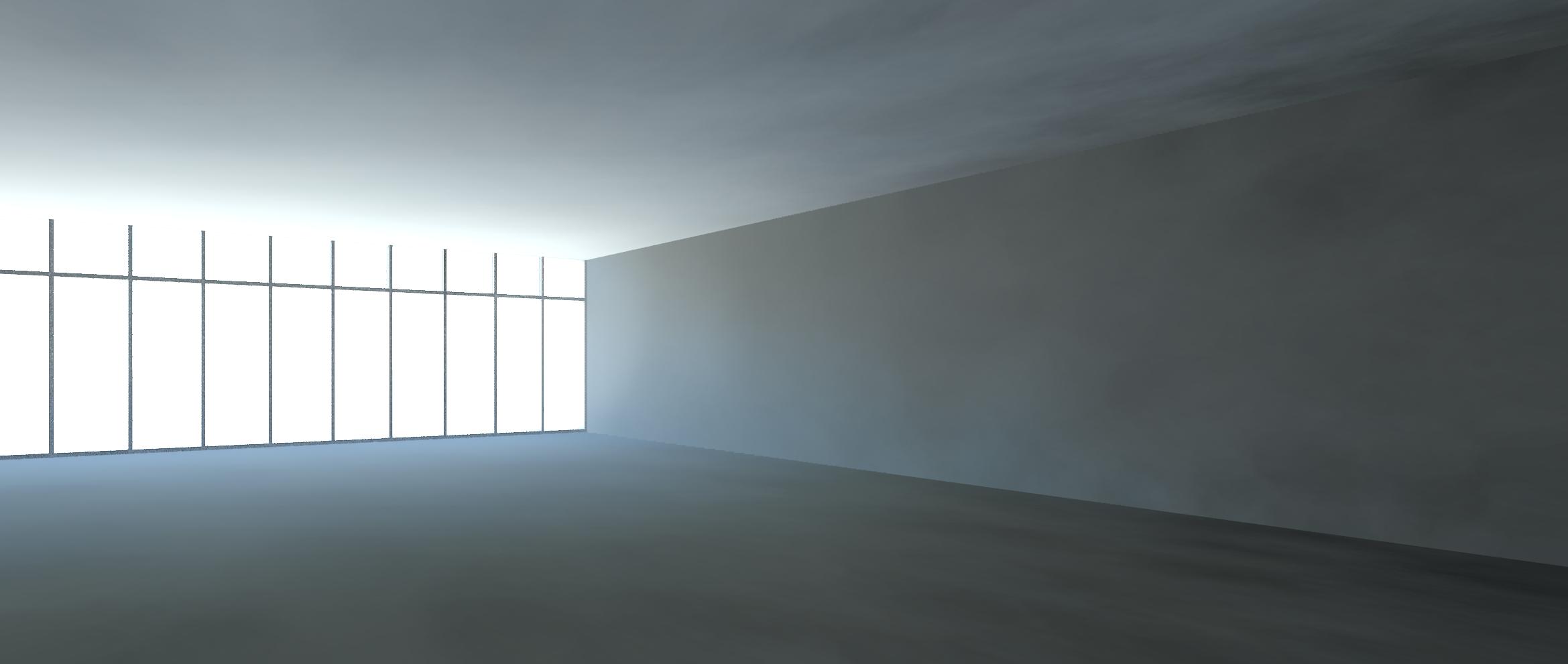

" I get massive over exposure of sun."......" I would like to see out of the building without getting the massive glare.  How do I do that?"......See the images 1 & 2
 " Why is the outside all black?"....Maybe because it's 7:30 PM....(" I changed the location settings to be at 7:30 pm in May in Atlanta")
