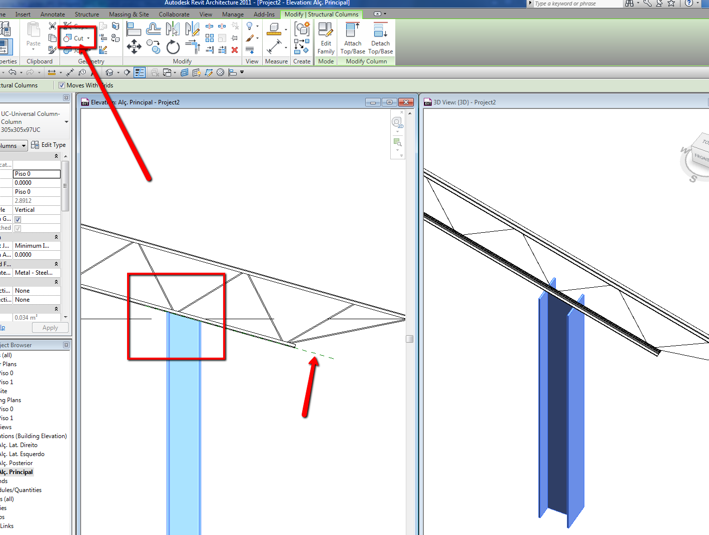

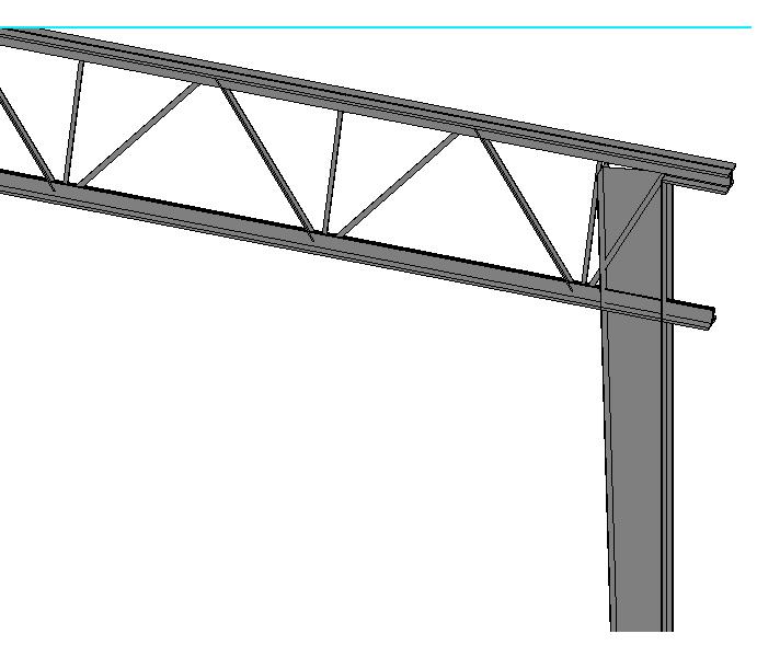

hi all,
If you have any ideas to connect these two member i will be appreciate. I can not control coping of the girder to column. thank you very much
Sat, Nov 13, 2010 at 2:30:09 PM | coping the girder
Joined: Tue, May 22, 2007
5921 Posts
4 Stars: 205 Votes
You want to connect that Column to the bottom of the beam or to the top of the beam? You can create a ref. plane and use the "Cut geometry" tool to cut that column, if this is what you want...
Sat, Nov 13, 2010 at 3:16:50 PM | coping the girder
arcnap09
Joined: Thu, Oct 14, 2010
14 Posts
5 Stars: 1 Votes
Thank you very much, Cut seems working  well.
