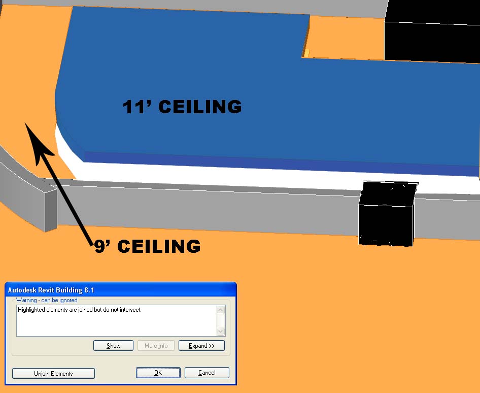

I am having soffit issues as well. I am just trying to do a perimeter soffit around a room. So basically I want the soffit around the perimeter lower than the center. How do you do this? I have tried creating two different height ceilings but I can not join there geometries as they do not intersect in the "Z" axis. Any suggestions would save me a great deal of time. Thanks

Bhamels, Unfortunately there isn't an automatic bulkhead/ceiling trimmer tool built into revit the places and infilling element. You would need to create a special wall type then trace around your ceiling boundary and attach the wall base to the lower ceiling and the top to the upper ceiling. HTH.

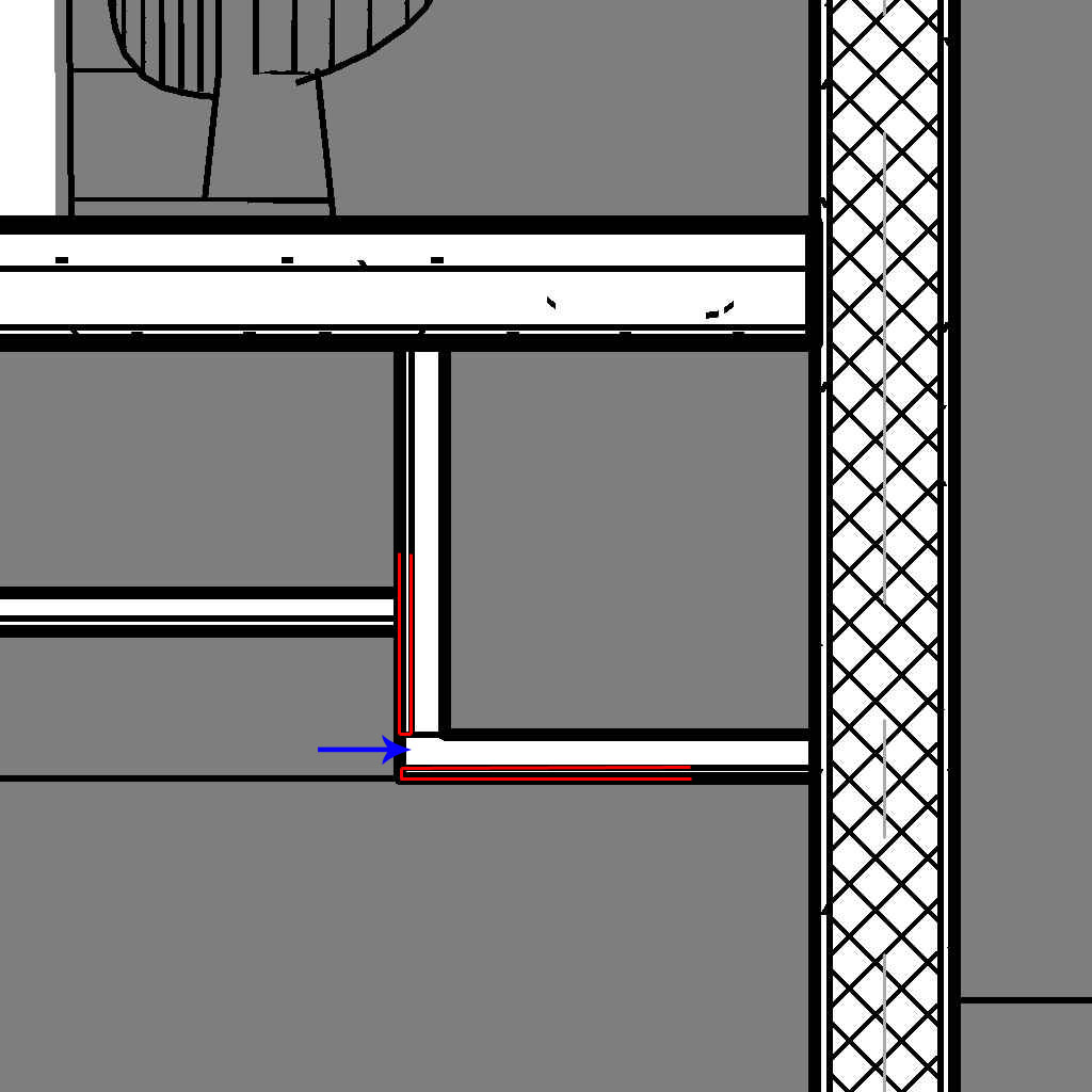

Mr. Spot, I think what archdan is trying to say about blank space is this gap that also appears in my soffits (look at the picture...)

You can get around this by not using the attach bottom option on the wall and instead overlapping the wall and the ceiling then using the join geometry to clean up the join.  It should then appear as you require.

No luck Mr. Spot, the best I can do is overlaping them and aligning to the gypsum board, but when I join them they get back the way they are at the pic. Thanks anyway and CONGRATS! ...btw if you have time please stop to see my other threads I posted, spacially the one with the shadow trouble.

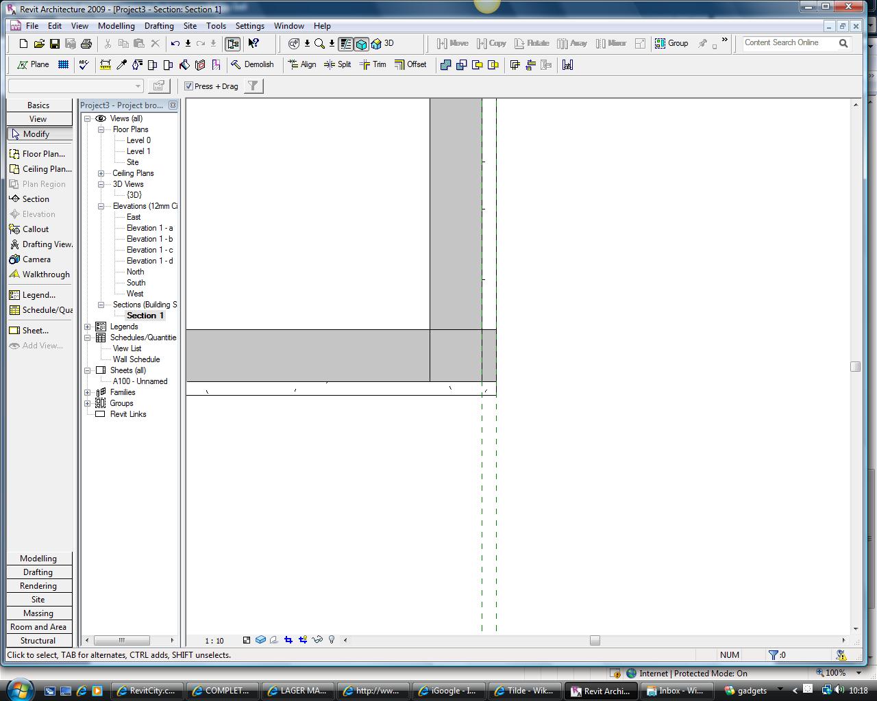

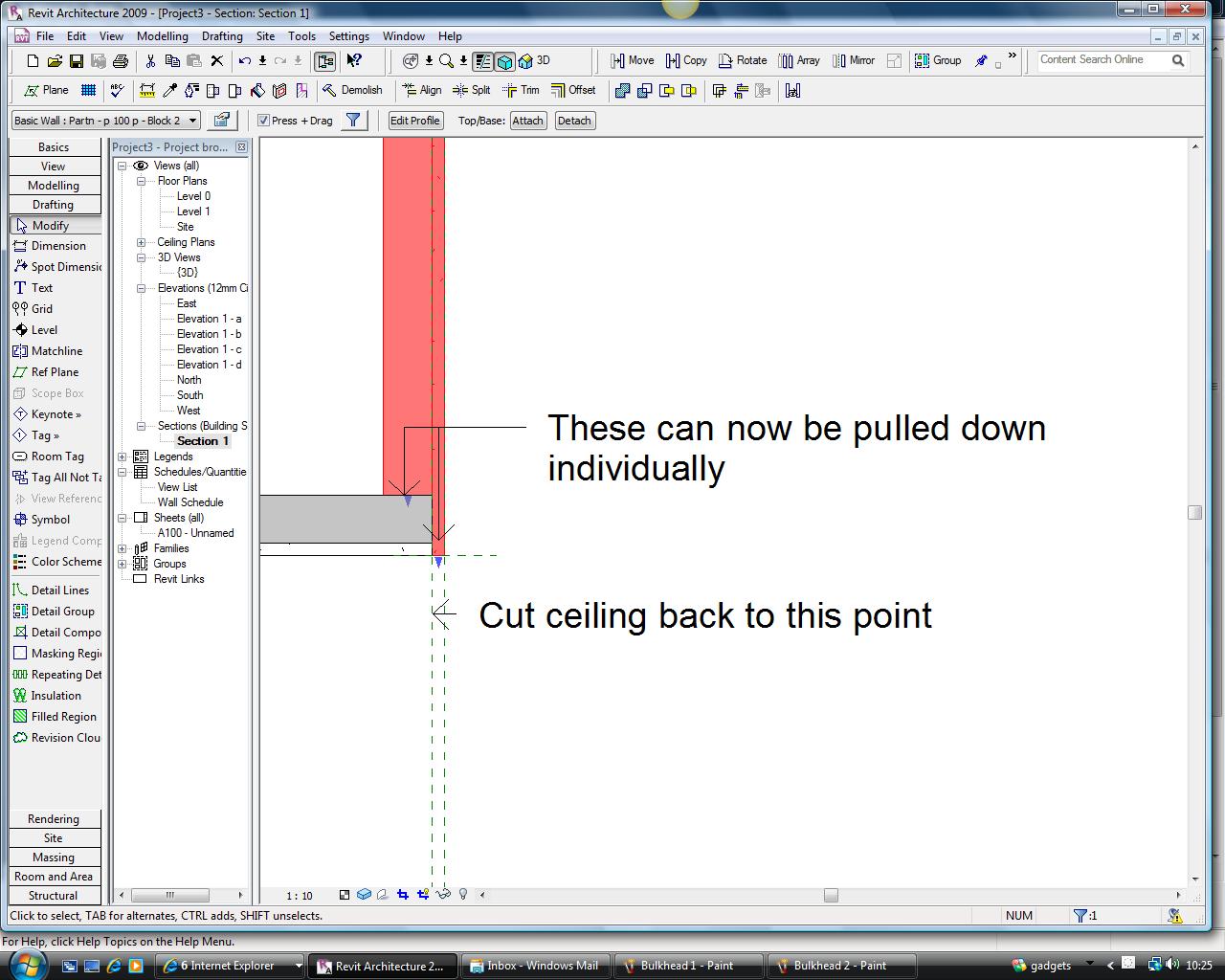

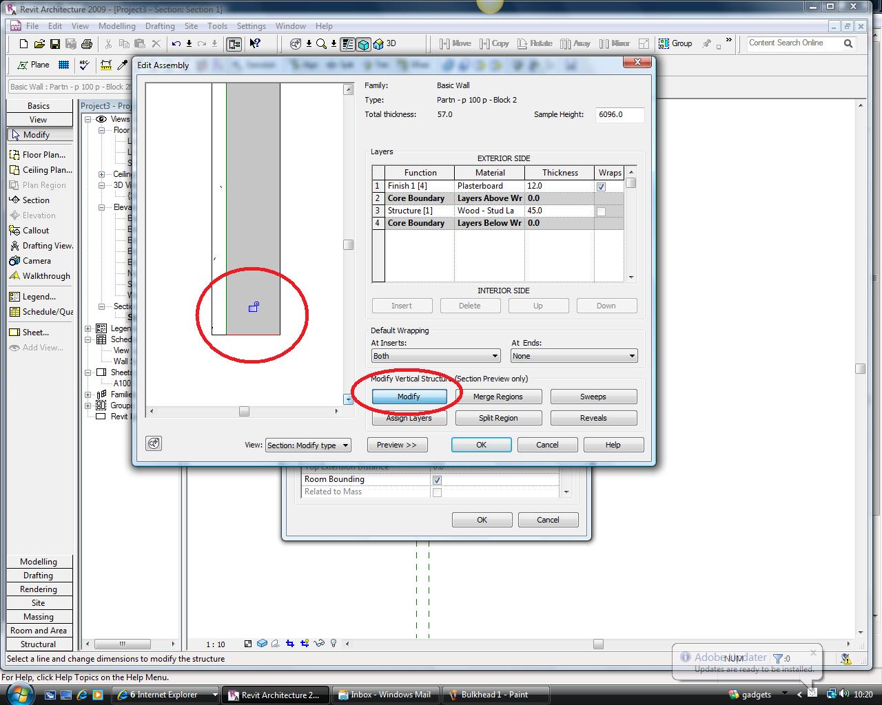

You can send a sketch by printing as a PDF, but much quicker to 'print screen' open paint (or similar), paste and save.
You can manipulate this join by unlocking the layers in the wall part.  The first image shows what I suspect is your problem.  Go to the wall properties and edit structure, check the preview and set it to section.  Click modify and unlock one of the layers (image 2).  You can now pull down these layers independently (image 3).
