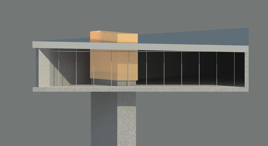

In the attached crude render from my revit file, the curtain wall glass is too transparent.  How do I change it so the glass actually seems present in this but still somewhat clear?

In Material dialog box check the "Glass" texture (that glass) and in Render Appearence you can change the values for Transparency, reflection, color and so on...
