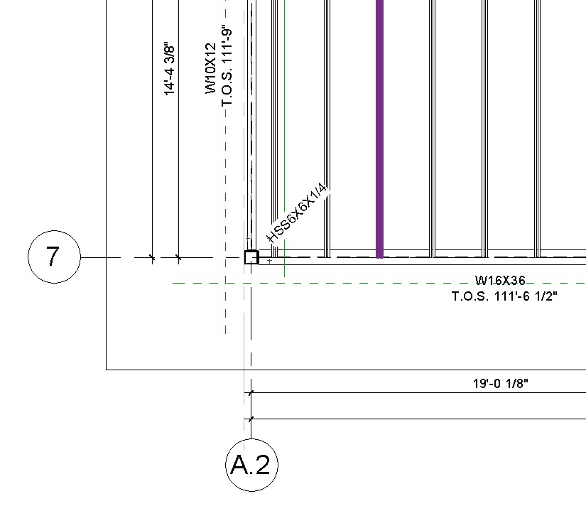

Anyone know of a combined Structural Framing Tag that will show the beam type and it's elevation?  See attached for image of how I'm using a standard framing tag with a modified spot elevation, to look like one tag.
I can live with using Revit's standard Structural Framing Tag and a spot elevation for both ends of sloped beams, but it'd be great to have a combo-tag for all the horizontal/level beams.

I do not belive there is a way to do this other than how you are doing it.  There is nothing tagable in the system family or a parameter in the tag that associates the beam with a paticular elevation.

In revit Structure, there is a way to do this. ANNOTATE menu->TAG->BEAM ANNOTATIONS.
Not sure about Revit Arch.

Try this tag out.  Seems to work just fine.
