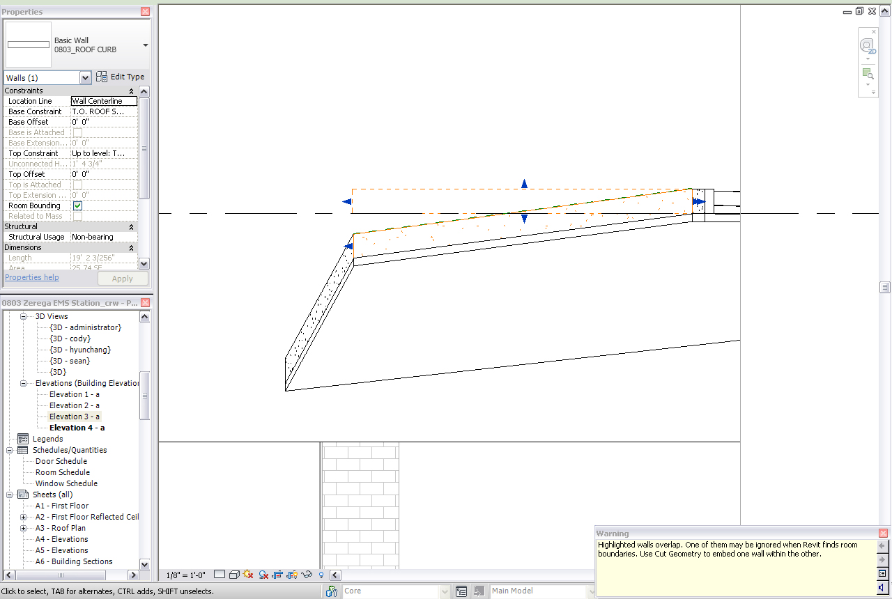

I'm trying to create a sloping wall as a roof curb that attaches to a sloping roof. I can create the slope by editing the profile but, alas, they cannot join together cleanly with other walls. Creating a mass is also fruitless, because, lets be honest, this tool just doesn't cut it compared to more sophisticated modeling software like rhino. I'm just wondering when this is going to be resolved? It seems like we run into this problem far too often and it makes revit look like it is falling farther and farther behind in the design category (not that design should be done in it). Does anyone have a method to work with this without a) modeling a mass, b) editing the profile or c) modeiling another program?

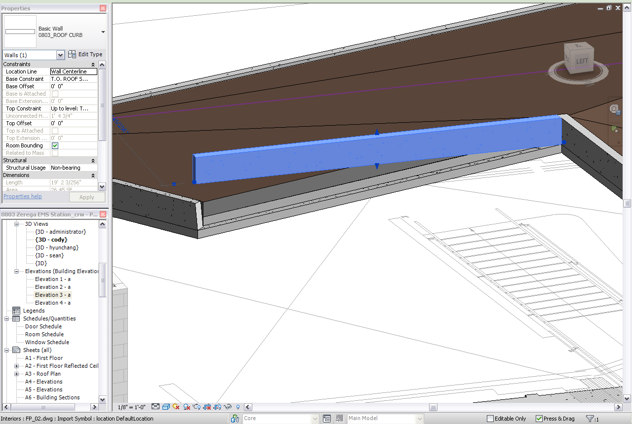

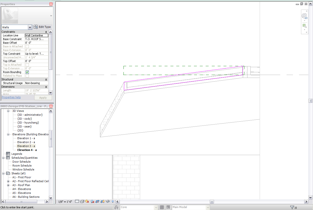

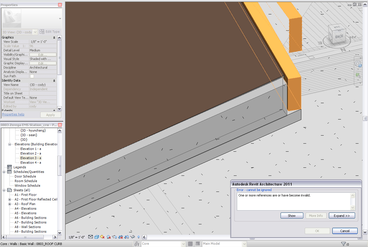

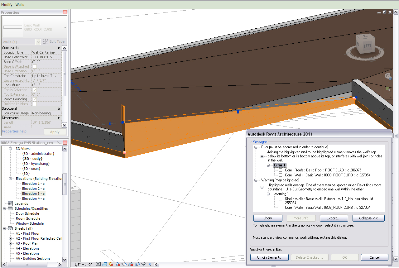

So I have been trying to work through some of the suggestions that you all have offered and attached are some of the issues that I'm having:
-Attaching the bottom of the wall to my sloping roof has a problem that I'm not sure what to do about, plus my name reference plane for the top does not show as an option in my properties dialogue.
-If I edit the profile I get the desired slope, with warnings, but I can't join to adjacent walls.
-The best luck that I have had has been with the in-place families created as a wall, but alas, I have no options to add to the structure or to create a coping profile. I would have the same functionality with imported rhino geometry.
Any other suggestions? I'm really trying to not resort to doing my modeling in rhino or some other program just to do a roof parapet. Thanks.

I don't understand either. It has a problem attaching to my roof, that's what I was trying to show in those images. As far as I can tell, all of the objects and constraints are modeled and set up properly; roof modeled as a roof, wall drawn on view associated with a level corressponding to the top of the roof, etc. It has a problem with the slope or something (it does slope in two directions in some instances). I want to keep it a wall so I can easily attached my coping profile without excerbating the problem with in-place family sweeps ontop of extruded masses and such.
Fri, Nov 5, 2010 at 12:12:14 PM | There's no end to issues with sloping walls!
#12
If your roof is warped (sub-points edited), then that may be a problem.  I would have to check that out.  But if the deck is flat and slopes in two directions, that should not be a problem.
In order to attach the bottom of the wall to the roof, the roof has to be under the wall and the wall may have to physically start above the roof.
