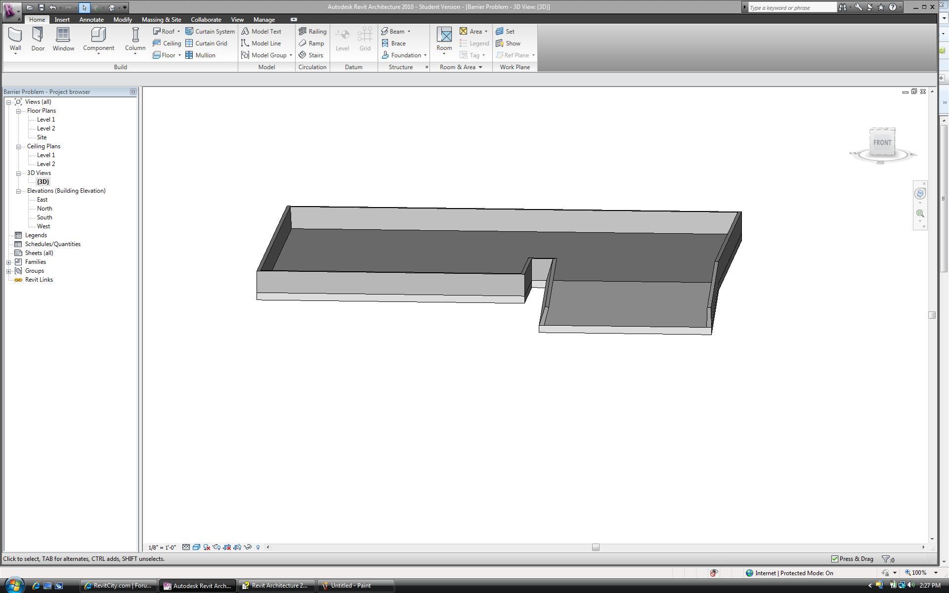

Hello all;
I am trying to draw a multilevel parking structure for a class project in Revit Architecture 2010. I have the floors done with the ramps utilizing the modify sub elements tool with no problem. I need to draw a barrier around the edges of the floor including the sloped ramp. I think I need to create a family but I have little experience with that and my instructor ?? is clueless. Could someone recommend a tutorial on the subject or point me in the right direction. I want to learn but not getting much help in class.
Any guidence will be most appreciated

hey pete-
there are several ways to do this. a few (but not limited to) include
walls-
 can simply draw a wall and edit each one to look the way you want
railings-
very cool for a cable barrier or such
hosted family-
will be able to slope with the slopes
generic family-
maybe something totally wild or very basic

9 Posts
A wall would be perfect, but how do you slope a wall for the ramp? I only want the barrier to be 2 1/2 to 3 foot tall.
Thanks much for your reply
Pete
Tue, Nov 2, 2010 at 2:06:16 PM | Barrier for floor with sloped ramp between levels
Joined: Tue, May 22, 2007
5921 Posts
4 Stars: 205 Votes
A simple way is: use a couple of "Ref. planes" and attach your walls (Top/Base) to those ref. planes

Hello Again
I've pretty much solved my problem by modeling in place, solid, sweep as seen in the enclosed project. Just one thing is wrong. The sweep work perfectly except for the left side of the ramp (note: this is just rough example of what I'm trying to do). For the life of me I can't get that section to line up with the rest of the barriers orientation. Any thoughts or suggestions would be appreciated

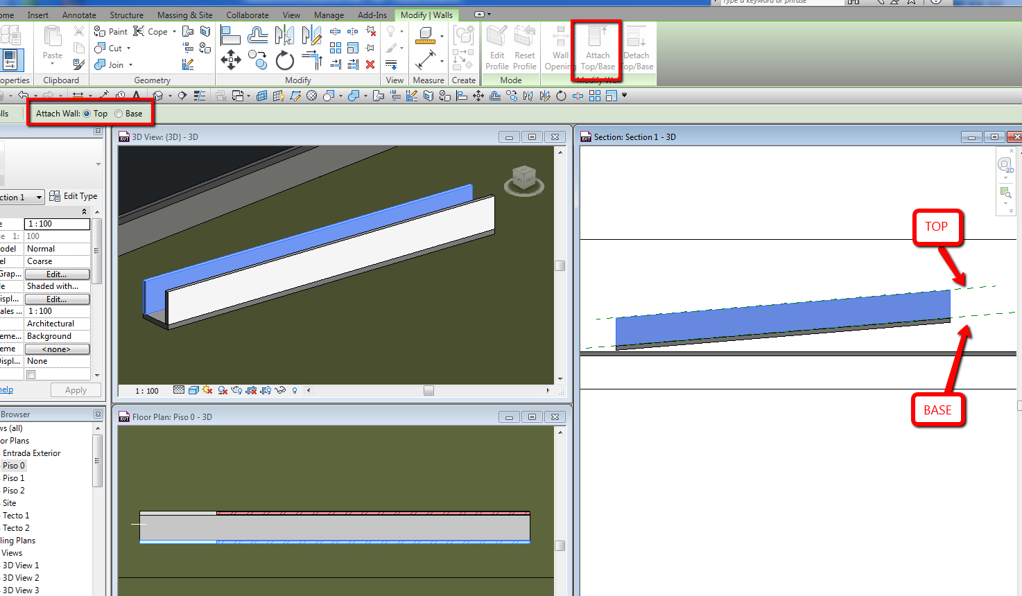

Thu, Nov 4, 2010 at 6:43:29 AM | Barrier for floor with sloped ramp between levels
#9
5921 Posts
4 Stars: 205 Votes
Why do you create that with a Solid Sweep when you can create that with only walls? For those "Sloped" walls, in a Elevation/section view you can edit those walls and draw the shape of that like you want.

Thu, Nov 4, 2010 at 2:10:56 PM | Barrier for floor with sloped ramp between levels
#11
5921 Posts
4 Stars: 205 Votes
Watch this: http://screencast.com/t/mKV2XvwO6M8B
