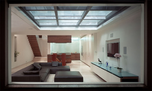

I'm trying to create a glass structural floor with mullions on portions of a floor. Any suggestions? I've tried several ways and I've failed...Here is and example of what I want. Thank you in advance

You can use the "Roof > Sloped Glazing" System, check in your HELP menu...
Tue, Nov 2, 2010 at 7:47:44 AM | Glass Structural Floor...PLEASE HELP ME
You could do as ty suggests but I would model as a glass floor then add an in-place extrusion that is the grid of the structure and that family would be assigned to the floor category.

Thank you both...How do you model as glass floor...I'm kinda new to Revit, Model in place? Massing?
Tue, Nov 2, 2010 at 3:40:00 PM | Glass Structural Floor...PLEASE HELP ME
If you are doing it my way, you create a floor and assign the thickness to the thickness of your glass and assign glass as the material.  The structure would be an in-place family.
If you are doing it typhoon's way, follow the HELP as ty suggested.
