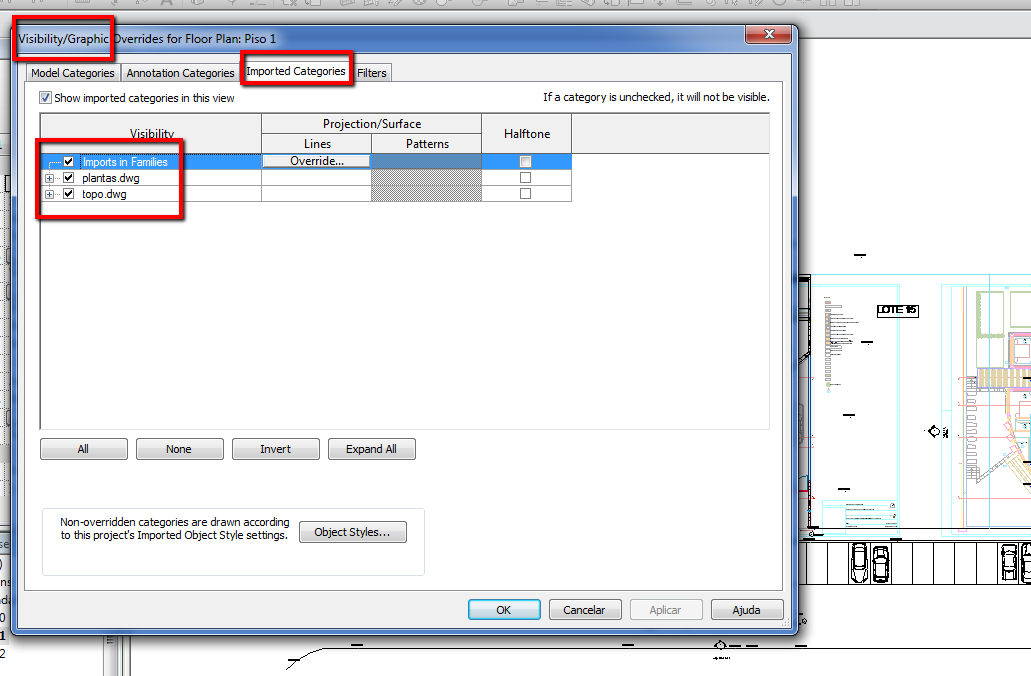

I imported a sketchup file as an object - I was in a huge hurry and trying to save time or I would have created it as a family. Anyhow, it's in my main floor plan and I wish to hide it but it just won't allow me to do so. It does nothing when I hover the cursor over it.  I am a bit of a newbie so I 'm hoping it's just a simple fix. I am working in Architecture 2010. Thanks.

Did you try by pressing the TAB key until it's selected?

In VG > Imported Categories uncheck the imported object you want to turn hide.

Thanks. Visibility Graphics/Import Categories worked. I had tried that but with the model category turned off it wouldn't let me select it. Once I saw your reply I went back and figured it out.  Thank you.
