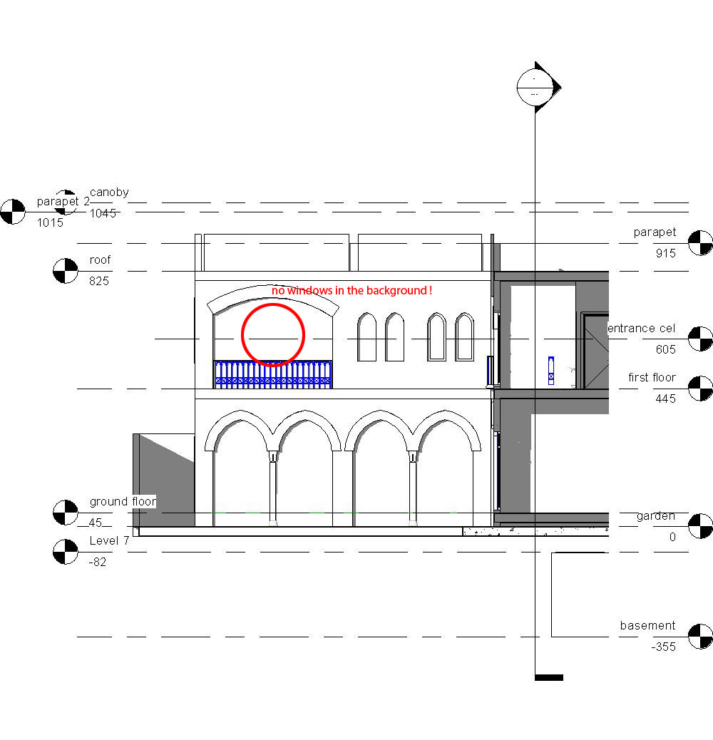

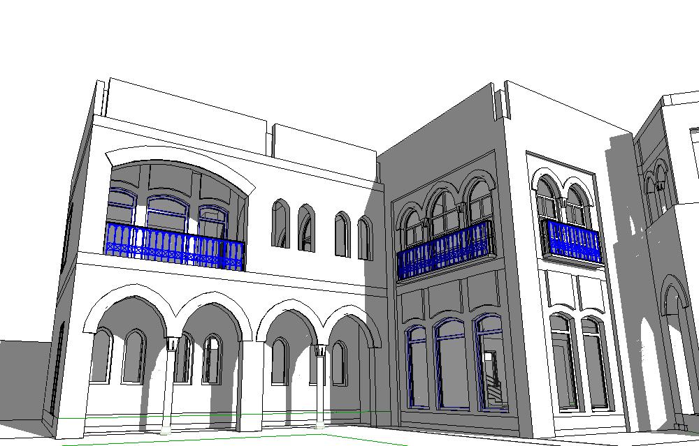

hi all,
I am using revit 2011 and made some door and windows family but as an opining only, the problem is that is show great in 3d and plans, but the problem is on elevations, an opening should show the stuff that is behind it but it doesn't, what sis i do wrong ?
thank you.

Wed, Oct 27, 2010 at 10:59:00 AM | problem with a door family
Is that elevation depth deep enougth to see the items in the background?
Wed, Oct 27, 2010 at 11:06:27 AM | problem with a door family
yosab
Joined: Fri, Oct 23, 2009
15 Posts
yes, the depth is all the way to the end of the project.
Wed, Oct 27, 2010 at 11:35:47 AM | problem with a door family
If the view depth is correct, I suggest you look at reveal hidden elements because you have turned them off in VG, hidden them, or they are in another workset or phase.
Wed, Oct 27, 2010 at 1:02:53 PM | problem with a door family
yosab
15 Posts
sorry, but it didnt work.
Wed, Oct 27, 2010 at 1:11:56 PM | problem with a door family
JAMESHGRIMES
JAMESHGRIMES Avatar
Joined: Fri, Apr 14, 2006
584 Posts
4.5 Stars: 10 Votes
In the family, Select the Opening Cut object and look at the Options Bar at the top of the drawing area. Select the checkmark box that say Transparent in - Elevation
Wed, Oct 27, 2010 at 1:19:38 PM | JAMESHGRIMES
yosab
15 Posts
Quoting JAMESHGRIMES from 2010-10-27 13:11:56
"In the family, Select the Opening Cut object and look at the Options Bar at the top of the drawing area. Select the checkmark box that say Transparent in - Elevation"
Thanks alot james, it worked just fine.
