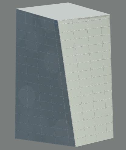

Hi allI have a problem with rendering my mass. I used curtain wall, but they are seen as a mass when I'm done with rendering. I've tried to choose glass as a material, but it does not help (see attachments)Is there anyone who can help?

as you can see you'r mass is trun on.
the mass as a txture as well so you need to trun the mass off and then to render.
