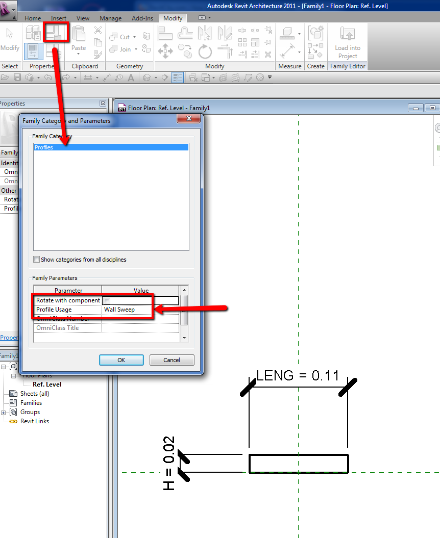

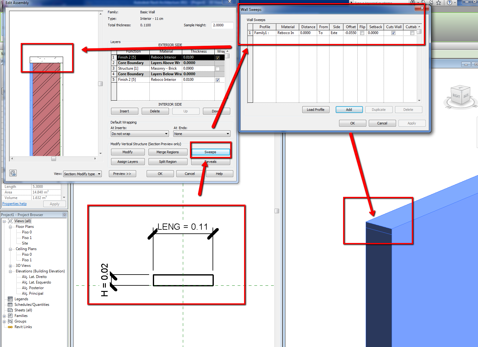

Like you can see, you can create a Profile in a "Metric/Imperial profile" family where you gona change in "family category and parameters" the profile usage to "Wall Sweep" then load into project and you can add that profile in the properties of that wall to create that sweep in the TOP, where you can change the material like you want.
