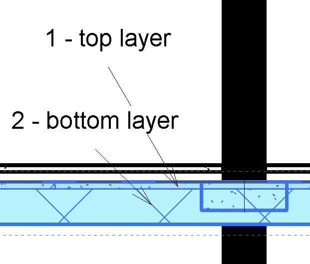

Hello,does anybody know if it's possible to havea floor whose structural usage is NOT slab?
I want the beams to CUT the slab and not vice versawhen I join them (I mean in section, it always happensthat if I join them, the beam is cut)In Italy, Floors are NOT structural,only beams are.thanks in advance for your reply!

You can alter the 2d cut results of joining the floor and the beam with the 'cut profile' tool.
How it cuts may depend on the floor layers and associated function.
Floors 'are' structural but it's a just matter of whether it falls within the responsibility of the architect or the engineer, right?

Thanks guys, so in Italy we have a floor made out of two layers:
Layer 1  -    5 cm concrete top                       - "structural" - material - concrete
Layer 2  -  16 cm terracotta bricks bottom    - "not structural" - material terracotta
The BEAM that passes through it is poured together with layer 1 - it makes "one piece"
with it. So, it needs to have its top aligned with the top of layer 1, melt its material (concrete)
with it, and  Cut layer 2. If it was a wall, it would happen by making the floor as non structural,
but since it doesn't seem possibile...
what else can you suggest?
I am looking for automatic feature, since otherwide i have to cut profile of so many floors and beams!
thanks in advance,
Stefano
