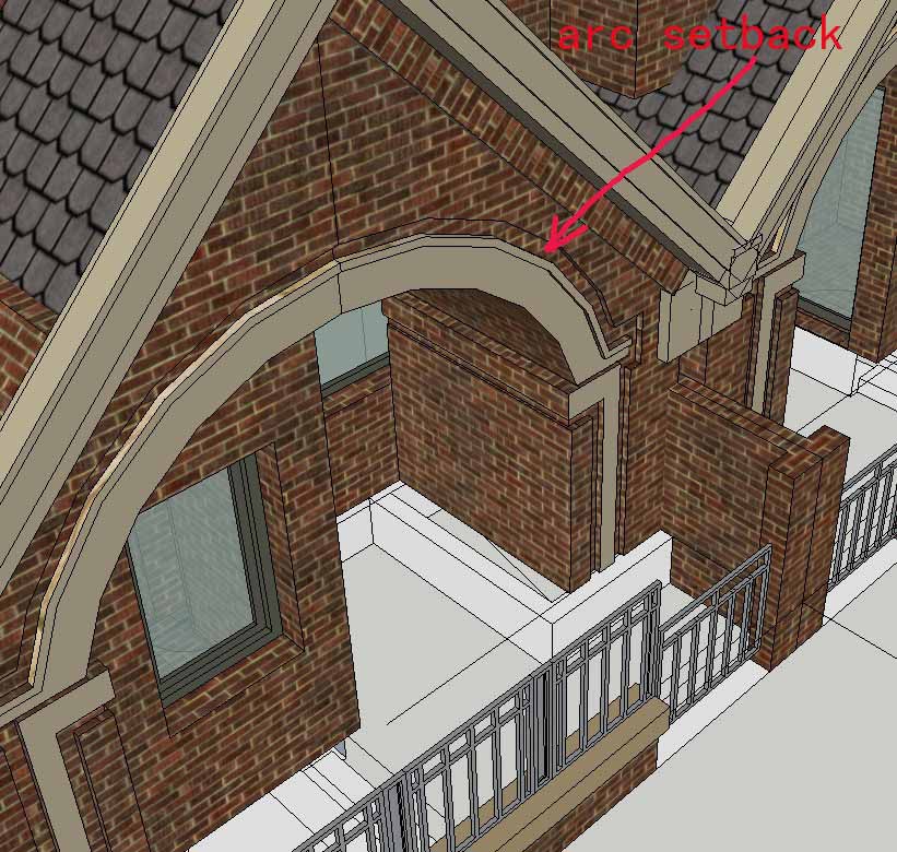

I want to make some setback in a revit wall , like a square shape or other shape setback in a wall but not doing an openings. I found reveals can do part of this, but if I want a circle shape setback in a wall , the reveals can't do this. look at my picture I want to make an arc setback.

the ARC setback is labled like this place. this is a model in sketchup.

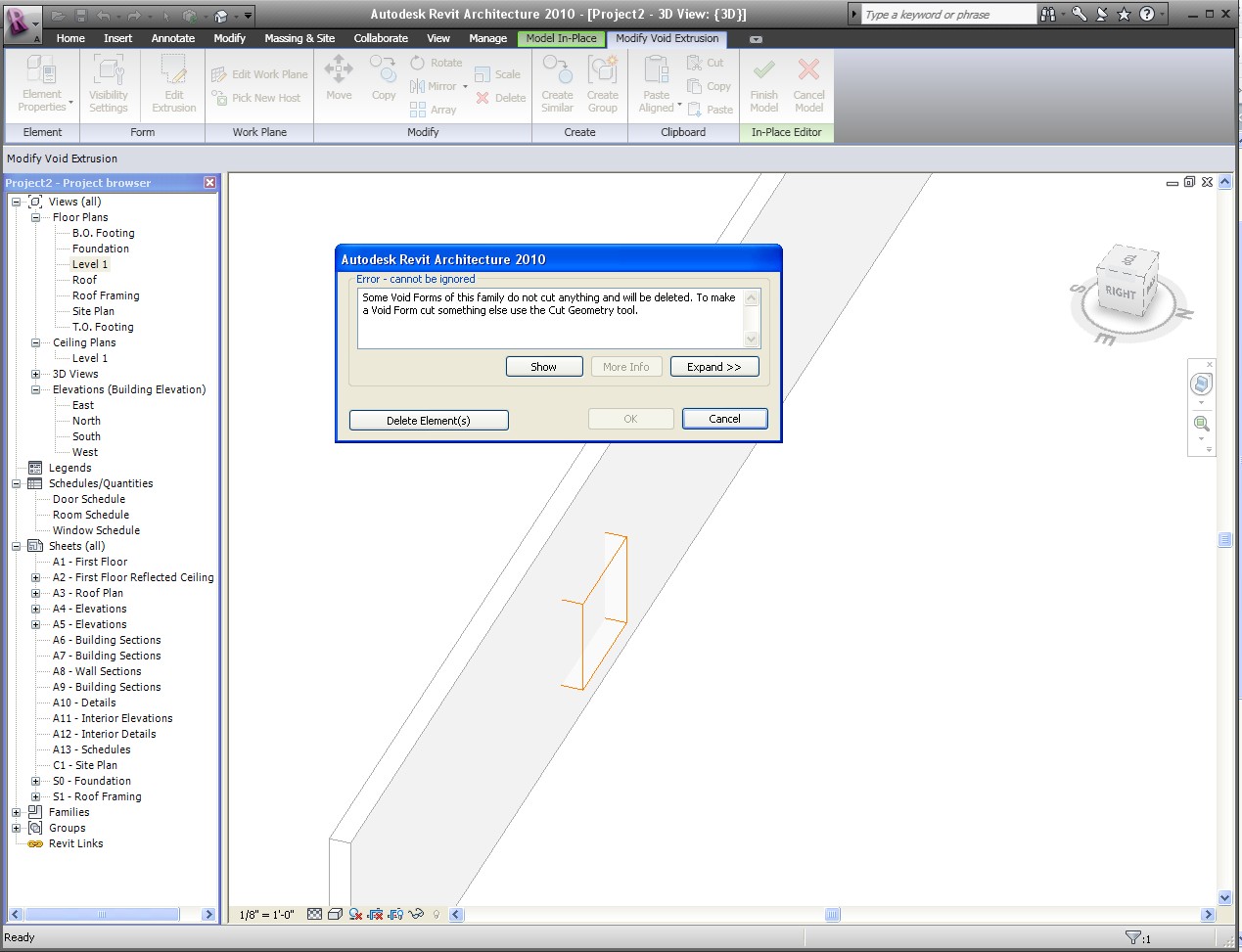

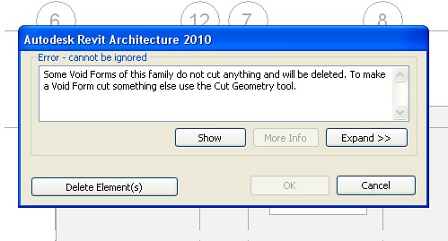

as I followed your step make a in family void wall, but it can't finish the shape. as the attachment show the revit errors.
Some Void Forms of this family do not cut anything and will be deleted. To make a Void Form cut something else use the Cut Geometry tool.

Did you do that? did you select the "CATEGORY: WALL" (not "MASS"Winking?
After this, go to a 3D or plan view and check if the void is cutting the wall like you want, then use the "Cut geometry" tool, select the void then select the wall, now you can finish your "in-place" (system) family.

I have do the steps  exactly as you have told me.
1. first I made a wall in a project file
2 go to elevations select a work plane
3 I select an in place family under category of wall
4 I make a void and place it in the wall
5 I finined the void
6 last I can't finished the whole molde
why , is there somthing I have missed?
  the last  step in the I have grasped as a picture shown below.
