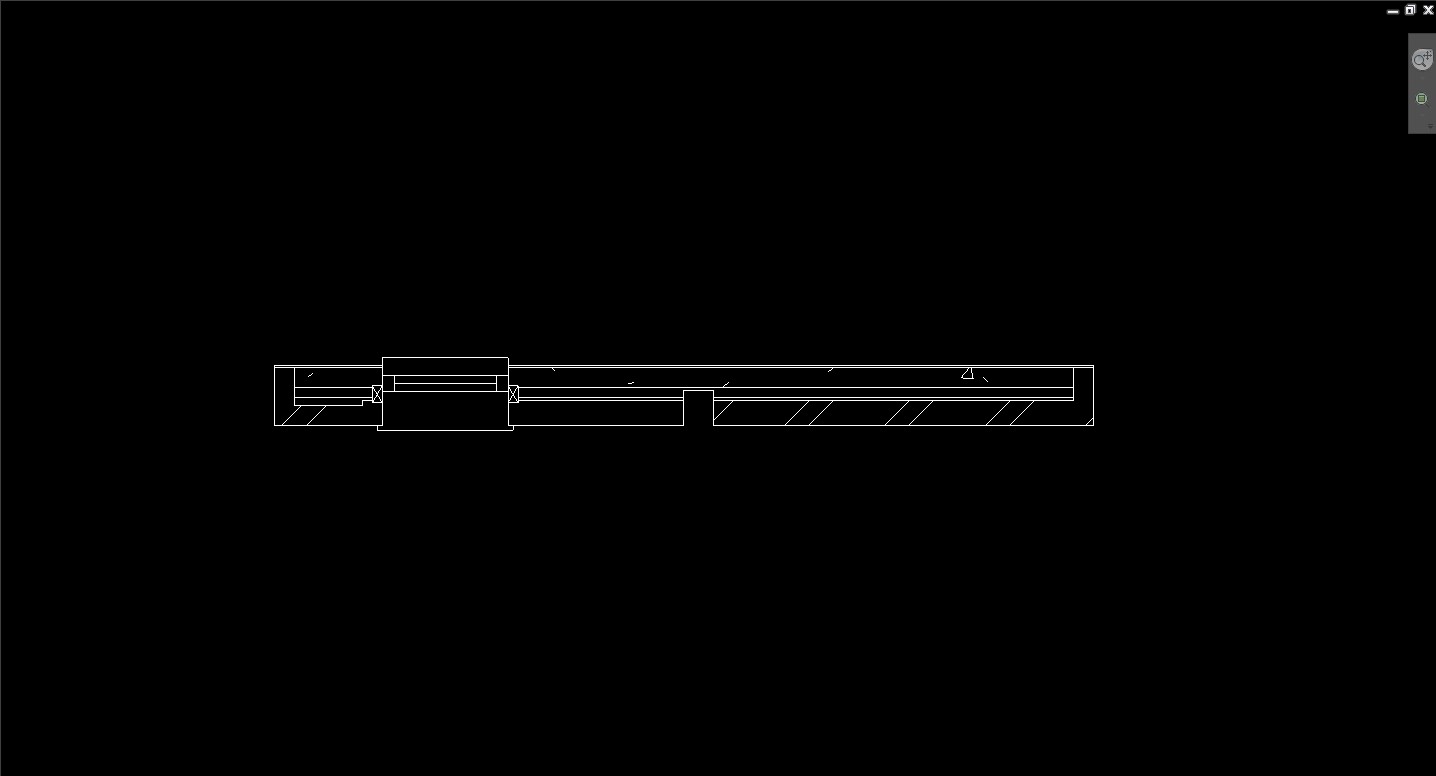

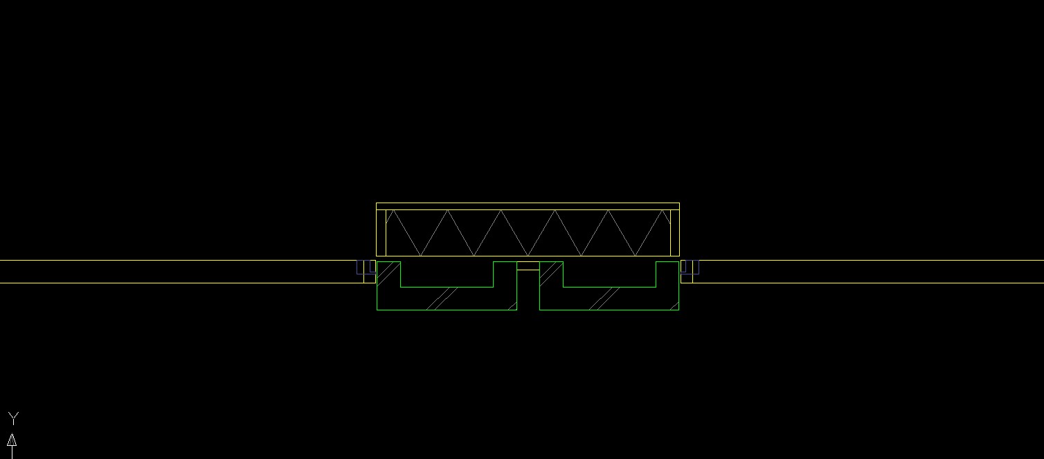

Hi,
I would like to have wall wrapping around the reveal part and window , now it only works at the wall edge see the CAD effect I would like to achieve  and the problem I have in Revit.
Thanks in advance
