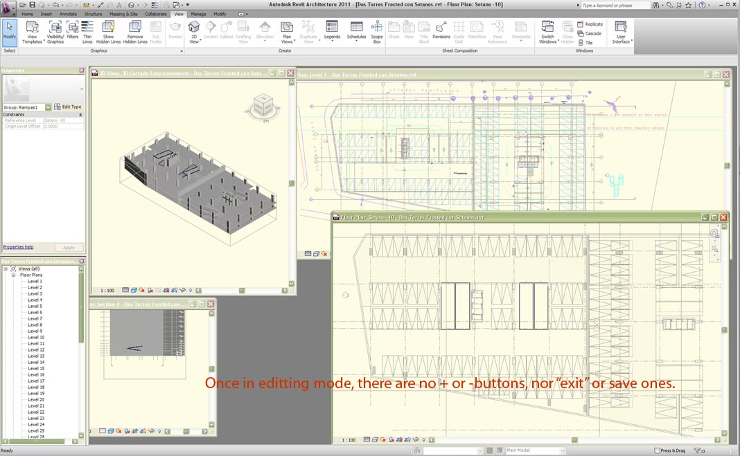

Thank you for your attention. I really don't mean to take your time with superficial questions (this looks like a stupid one), but as far as I can see, the new version 2011 (64x) has this very obvious glitch (in 3 separate computers here): once I click "edit group" (to add/remove elements from/to it) I cannot go out. Not even the "add" "remove" buttons are showing, so the only available option is to Undo (or shut Revit entirely). I have downloaded upgrade2 and everything seems up to date. Any help will be appreciated. Thanks.

http://www.revitcity.com/forums.php?action=viewthread&thread_id=20684
Maybe this solve your problem.

There it is; thank you very much! this 2011 build has this very bizarre behavior: as the link you provided stated, I had to activate/deactivate the "Recent files" option (on User interface) while editing my group (!), and suddenly the add/remove/save buttons were floating there. Bizarre.
