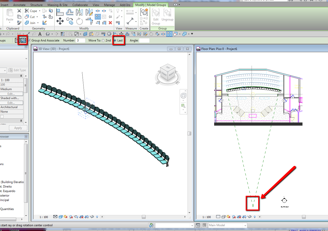

I have a revit chair that I'm trying to array (or copy) to follow the 2-D drawing layout I've attached to this thread.  The chairs are arranged next to each other in a arc.  I tried to array but I'm getting no results.  Can someone help me with suggestions or a tutorial?

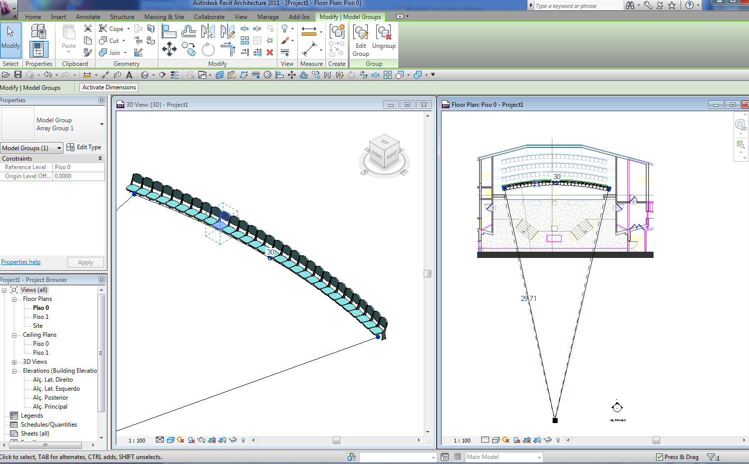

Just create a "model line - ARC" in plan view, then create the Ref. planes to the center of that model line like you can see in the images, after this use the "radial Array" and DRAG center of rotation to the end point of those ref. planes, use the last option....
