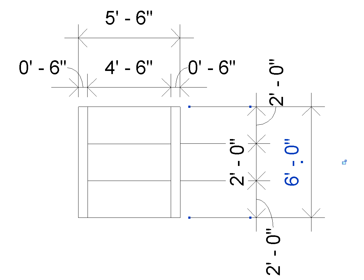

I need to create a .pat file for this custom ceiling grid but I never done this before any ideas on how to go about this?  Thanks
Thu, Oct 14, 2010 at 10:14:09 AM | Custom PAt File Help Please!!!
How does this pattern repeat?

Here you go!  Thanks

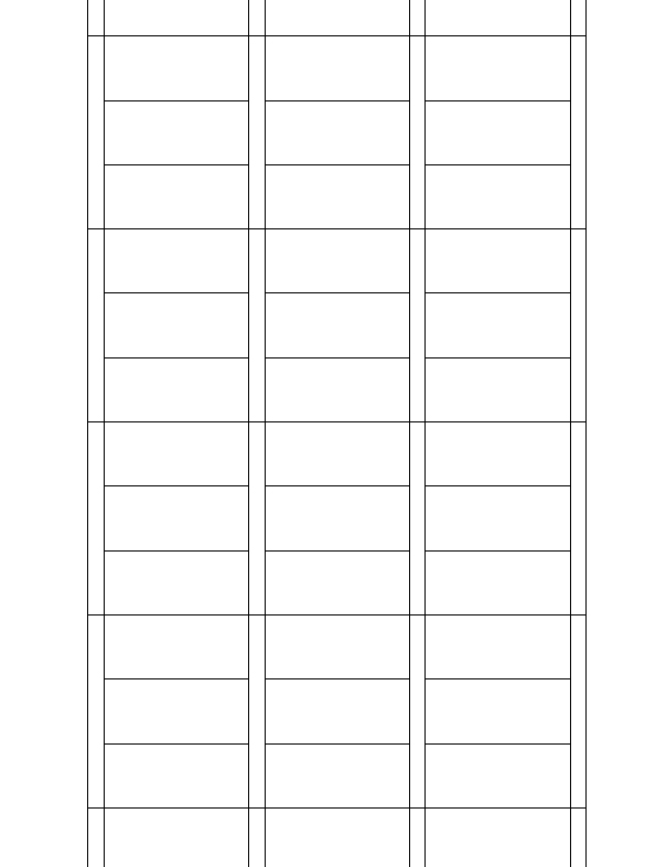

The attached pattern is based on the template in the original post and contains three unbroken and two broken line elements:
;%VERSION=3.0
;%UNITS=INCH
*CCGRID,Custom Ceiling Grid
;%TYPE=MODEL
;        Pattern written by HatchKit v2.7 Hatch Pattern Editor
;        HatchKit v2.7 Hatch Pattern Editor(c) Cadro Pty Ltd 1990-2008.
;        www.hatchkit.com.au
;-Comment =RevitCity21970
;-Template=NEW,
;-Date    =15/10/2010
;-Time    =11:32:40 AM
;-HatchKitVersion=2.7.1.1995
0,6,48,0,72,54,-6
0,6,24,0,72,54,-6
90,6,0,0,60
90,0,0,0,60
0,0,0,0,72
The origin is at the template's bottom left.
