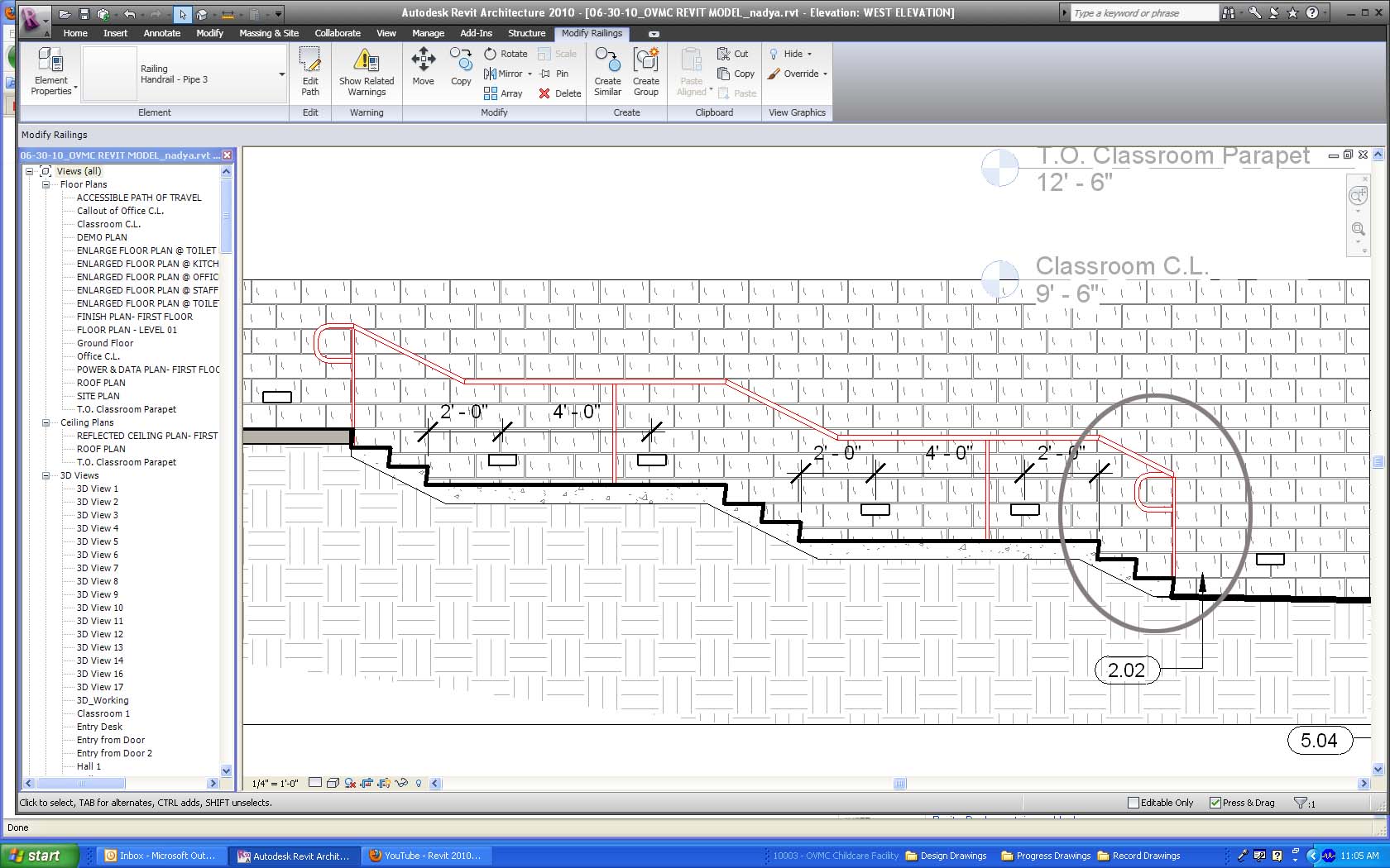

Hello,
 I finally managed to figure out how to add the end baluster  to a handrail, but now the end baluster  i added to the railing is showing up in the wrong direction.  Does anyone know how I can rotate this?  It's also not lined up with railing in plan... Appreciate your help! Thanks.

It has been awhile since I did one but I believe you need two different families... a start (bottom) and an end (top).
Just duplicate the one you have, mirror the solids in the family and identify differently - re-load into project and use accordingly.
