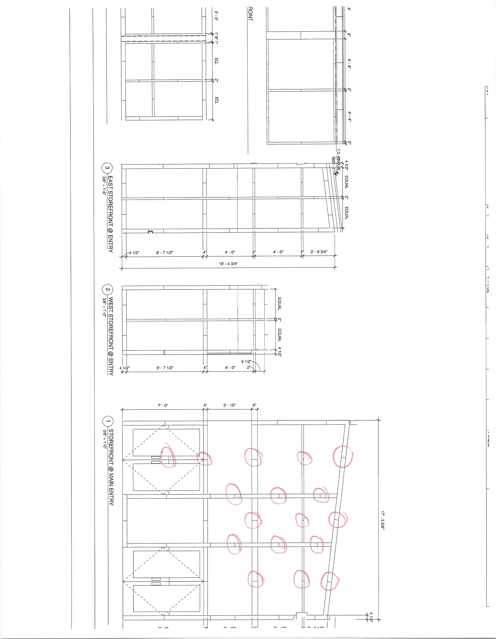

I have attached a drawing showing the sections.

Your elevation (not section) that you posted don't show me anything.  They look ok and they don't show a door.
Perhaps if you add some notes about where you are having a problem and be more descriptive than "... All of the mullions that I insert on my curtain wall gridlines are divided in the mid span. "

I have attached elevations showing the mullion "sections".  I circled a few of them so you can see what I'm talking about.  Notice the doors have also been divided.
Tue, Oct 12, 2010 at 12:36:09 PM | Curtain wall mullions divided
Thanks, now we can understand the question.
Look at your material settings for what you have assigned to your CW mullions and door.  I believe this is a surface pattern in that material.

That was it.  Thanks a lot.  I would never have thought of that.

As you can see, your original question was very miss-leading.  You thought there was a "split" in your mullions and that really tracked us in the wrong direction.  The image was the key to understanding the problem.
