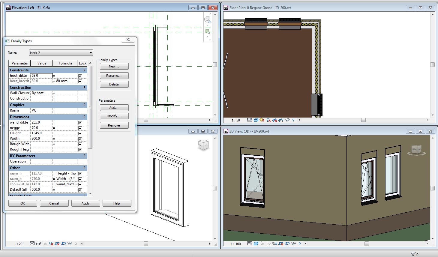

Hello,
problem with a window, one family, 2 diferent heigths, please take a look to the embedded file. One window will show the correct cut, the other one lookts to be ignored in the cut...?
Any ideas? Thnx!

http://www.revitusers.nl/images/fbfiles/images/Capture.PNG
 This is a screen capture of the problem.Same window, different measures.

Okay,
moving the cutplane doesn't changes anything. I don't know how to make this clearer with a screenshot, but I made this one (attachement).
Strange, no matter what cut plane height I set, the 2 windows don't change visual, except when I put the cutplane ABOVE the windows, the view changes as expected. But setting the cutplane to go through the windows will give me this view.(Adjusting the cutplane also would not be the final solution, because we have to cut at a plane 1500mm above the floor, by government laws.)
I have read something about this has to do with sill heights etc? But just can't figure it out exactly, hoping someone could explain here...
Thnx!

Hello WW,
here is the window. You can adjust several things in it, let me explain:
-hout_dikte: thickness of the window profiles
-raam: the type of window, VG=glass VR=fixed window L=left turning window R=right-turning window P=panel
- wand_dikte: thickness off the wall that's gonna be in front of the window (we draw our walls in 2 parts, inside &  outside)
-negge: the horizontal offset value from the window to the front wall.
Hope you understand. Thanks!

Your problem is your nested families.
Why did you create the window this way?  This is really overly complicated.
Try deleting the nested families and creating what you need in this family.  Left - right can all be controlled with flippers.

There are some very complicated families out that work very well but is it worth it?  In some cases it may be but in most, I don't believe it is.  Check out this thread at AUGI http://forums.augi.com/showthread.ph...it+content.com
The problem you are having is caused by some Revit viewing rules.  If a family is not cutable and if any part of the family is in the cut plane, the entire family is shown.  That includes invisible lines in the family.  Your windows show even if they are above the cut plane.  That means something in these nested families violate that rule.
