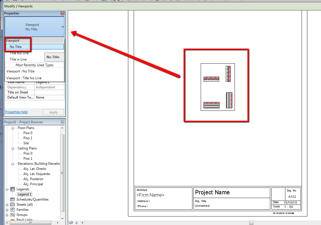

I am using revit 2011 Architectural.  When I try and place my legend on a sheet a title block pops up below my legend with the legend name and scale factor.  I would like to supress this so only the legend appears on my sheets.

Select the legend, properties > No Title

Thanks You.  That was exactly the help I needed
