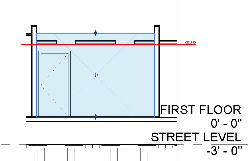

I have a simple room with a simple ceiling that is set to Room Bounding.  However, the room is not recognizing the ceiling as a room bounding element.  It displays the default 10'-0" instead.  How do I get the room to recognize the ceiling as room bounding?

I think I figured it out.  Incidentally, I am using Revit 2011, which does not calculate the room height automatically like pre-2011 did.
You must first enable Volume by doing the following:
http://docs.autodesk.com/REVIT/2011/ENU/filesUsersGuide/WS1a9193826455f5ff-54f556ca1166ac9ee9e-4abf.htm
Then set a formula for the ceiling height by doing the following:
http://revit.blogspot.com/2009/04/tagging-ceiling-heights-in-room.html
I'll let you know if I run into any problems.
