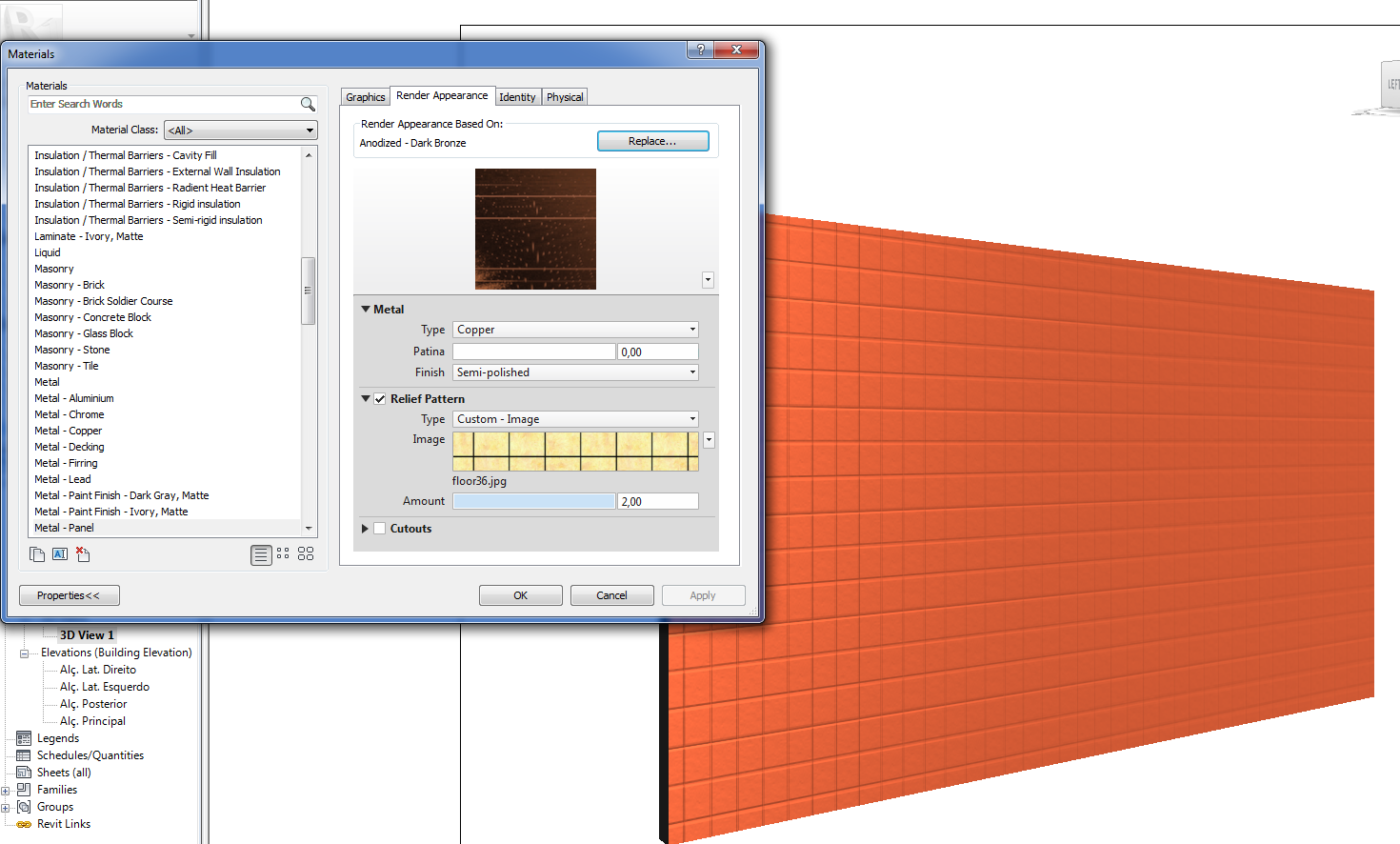

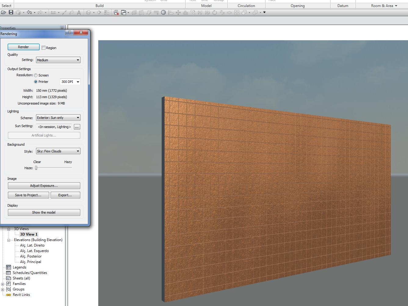

I can't see the pattern in your image, it's very small, but you must learn how you can adjust your materials with other "Custom Image" like you can see in my images...

Thank you for this, I did not realise that you could overlay an image like you have done,
 Did you just create a cross hatch pattern for the overlay?

It's just an image, not a pattern, choose the image you want, it's better if you use (in this case) "Alpha Channel" images like i just post...
