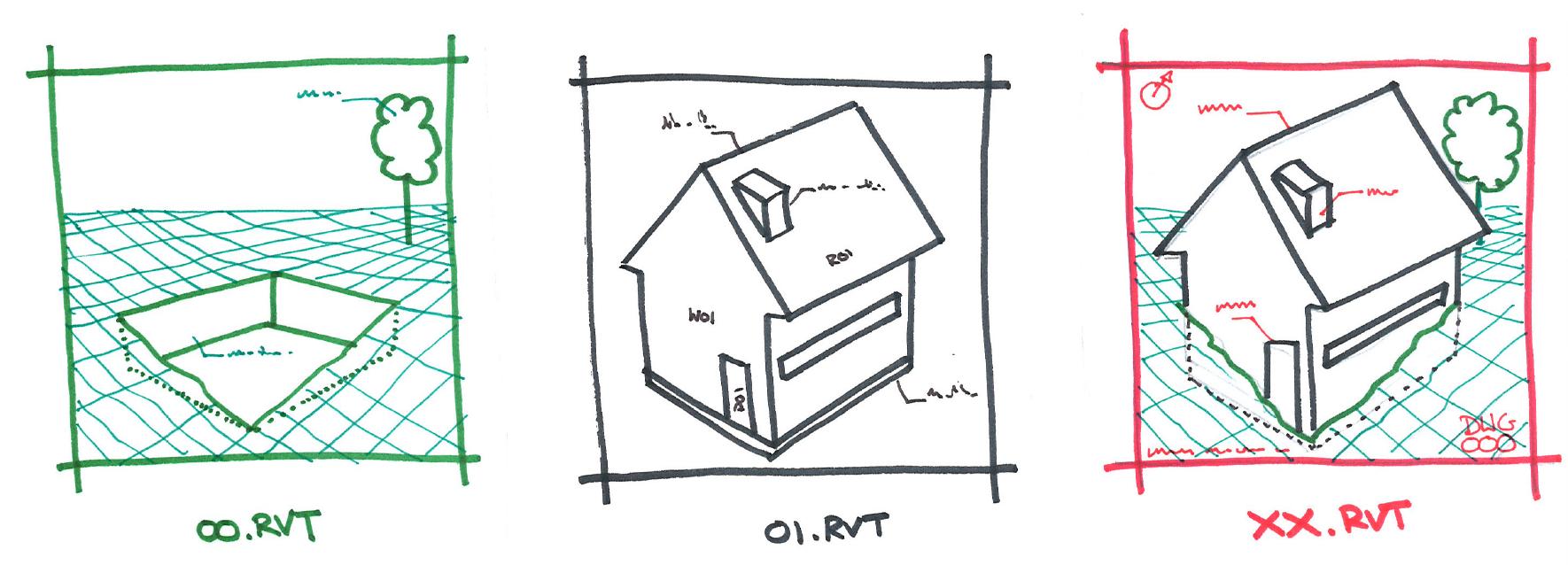

So we've our "site" model playing host to 5 seperate model files in which we prepare our sheet views for issuing (once combined) from out of our "site" model.
Oddly today we noticed that when linking to the model views (in the "site" model) the views come through okay, but the tags shift out of place... the model data is all fine, the tags just don't come through as they appear in the models themselves.
 It's a consistent "shift" - so I'm wondering if it has anything to do with recent "relocate project" exercises we've applied to some of the models... Any one else ever experienced this?

Sorry, I can see how "site" could have misled...
When I'm saying "site" I mean "project site & buildings entire" - essentially one blank model in which we manage our site grid, levels and location AND compile all our views for sheets that talk to the "project site & buildings entire".
We are linking to views setup in each seperate building model, but it's then the tags "jump" from their location (in the linked model's view) to somewhere else in the host view (of the "project site & buildings entire" model)
I've checked the shared locations of all the models, they are correct & are all linked by shared coordinates into the "project site & buildings entire" model.

I can kind of see where "site" might have thrown you. What I meant was "project site & buildings entire". We do have a "site" model that includes topography, pads, context etc but since we deal in numbers (rather than names) for our models we rarely encounter the confusion...
So to clarify; we have/use one model to setup & maintain project levels, grids & locations. We host all of our models (architectural, site and interiors) into this model for project-overviews, types management, scheduling and for the production of project-wide drawings (ie. "site" plans, long "site" sections, etc) - I've attached a quick sketch...
SO what we have is views in each respective model, some of which are placed into sheets in that model (when they only talk to that building) and others, are set up for linked-views in the "project site & buildings entire" model. It is this latter method, where we are using linked views in the "project site & buildings entire" model, where we're seeing the annotation jump.

I don't understand why you even have image xx.rvy.  0.1 rvt is all you need with 0.0 linked in, then you don't have any problems. If 0.0 is linked in a workset, you can always turn it off where you don't want it.  Nowyou never have to link by view.

What my simple-sketch fails to illustrate is that there's more than the one architecture model... there's 6 as we can't really have 1 person juggling so much building*.
Hence the multiple-users working on multiple-models making views, all linked into one "overview" model which looks at those linked views.
*Unfortunately my predecessor demonised worksets & central file working and I'm still at pains to counter his efforts.
