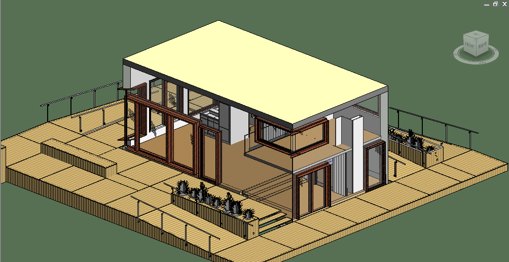

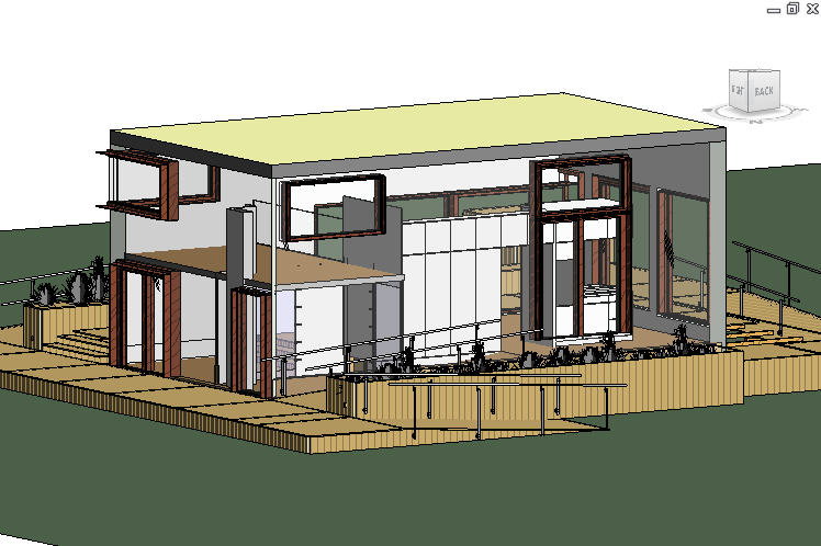

The walls are there, but when looking at them head on they become transparent, when I rotate the model to the other side of the building the walls that were transparent become solid and visible and the walls that were visible become transparent. So in a way you can always see through the building!
I have attached two images. The first one is the north view and the second one is the south view of same model. I hope I am clear this time.

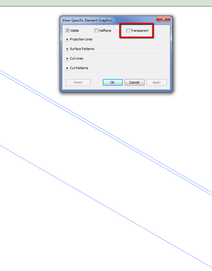

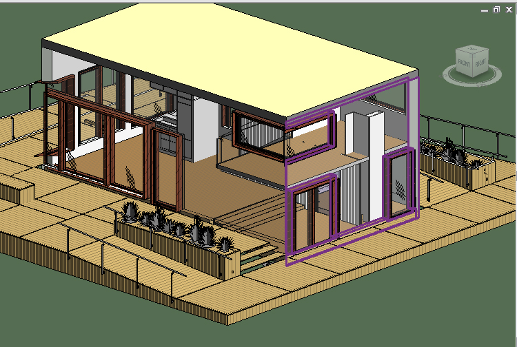

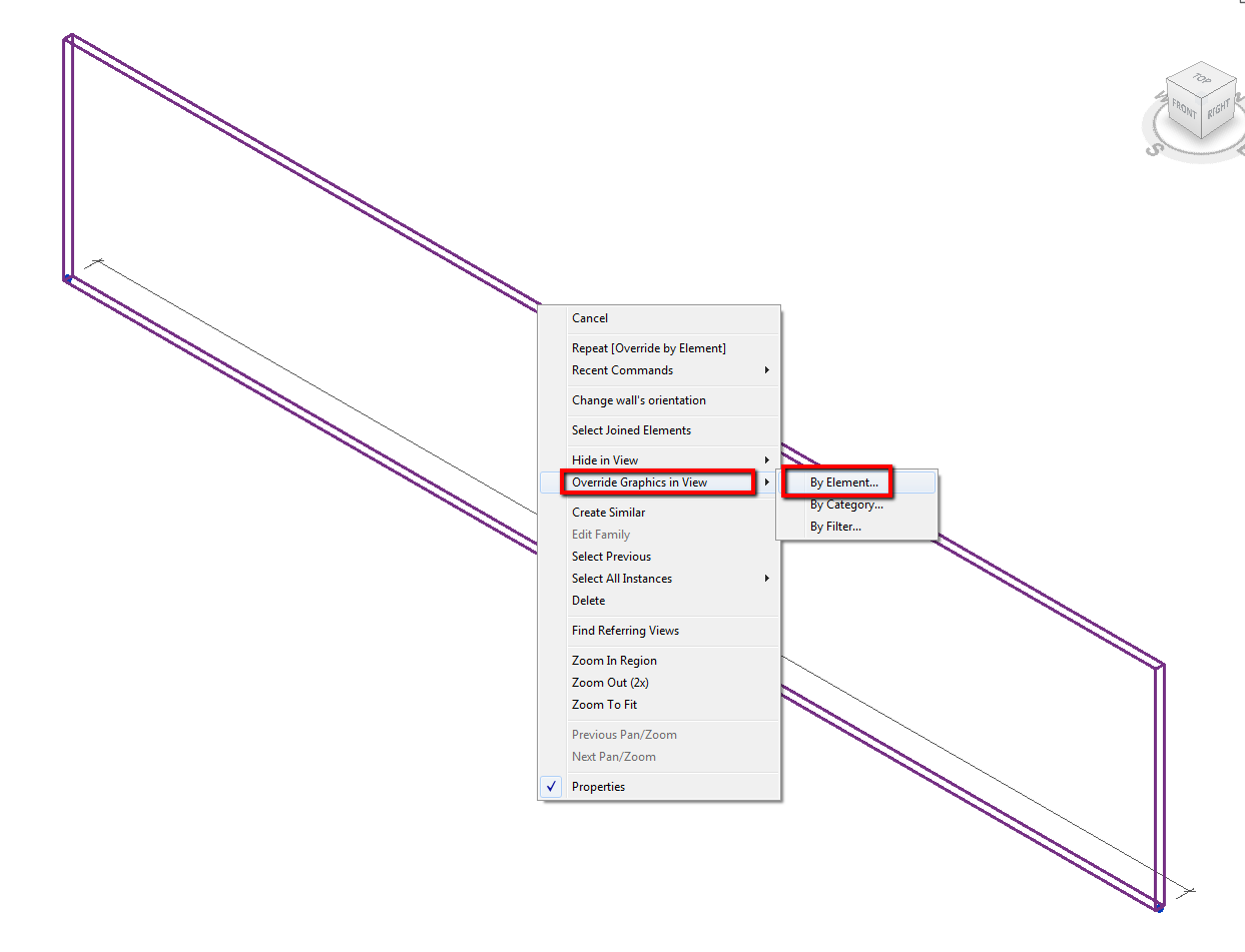

Also, like we can see you can select the wall, so, select the wall, right-click in your mouse then go to "Override Graphics in view > by Element" and see if you have the "Transparent" check, if you have just uncheck.
