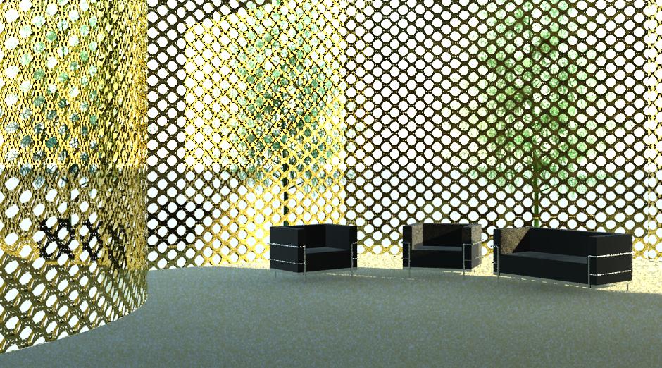

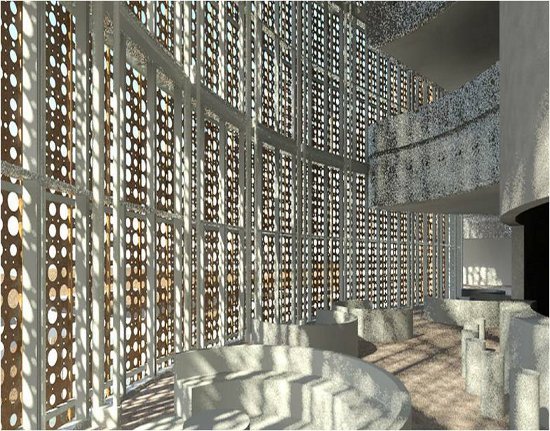

when we open revit architecture 2011.. 1 image comes up..!!
how can i make this type of wall...???
is dis project any how downloadable??
even if not, please can some 1 tell me how to make dis??
i have attched  a few images as to how it looks....
plzzzzz reply soon..!!!
82742_revit-architecture-2011.jpg82742_constrevitrarchsuitesigimage2011455x308.jpg82742_pic330802.jpg

curtain wall with a custom panel and or material

hi.... i'm not very good in english but i try to tell u how to make it!
first u should have a black&white pattern for your favorite wall.
second you can make your wall with mass or model in place.
i make it in MODEL IN PLACE/EXTRUSION.
after that, put your material(reflective is better).
in CUTOFF tab, put your pattern with favorite scale.
finally u can render it. good luck!
