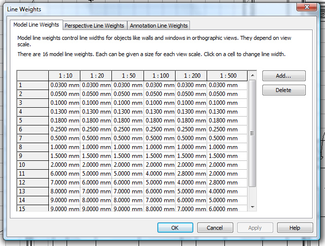

(by the way, when I'm talking about line weight settings, I'm referring to the setting in the attached image)
Anyway, I'm still stumped... thanks for your help though
Tue, Sep 28, 2010 at 11:05:53 AM | Line weights reverting to standard
Although that chart is available in the family, it is not controled by the family.  You will find a similar chart in the project and as I said, "...the project RULES".
If you are trying to use your CAD brain here - DON'T!   This Revit lineweight chart is a translator to determine what physical pen to use for each pen number at different view scales.   Every item in Revit is controlled by pen line weight number as set in object styles which is then modified through this chart according to individual view scale.  (The category or sub-category lineweight can be altered in any view through VG or for individual elements, it can be over-ridden in any view by element.)
