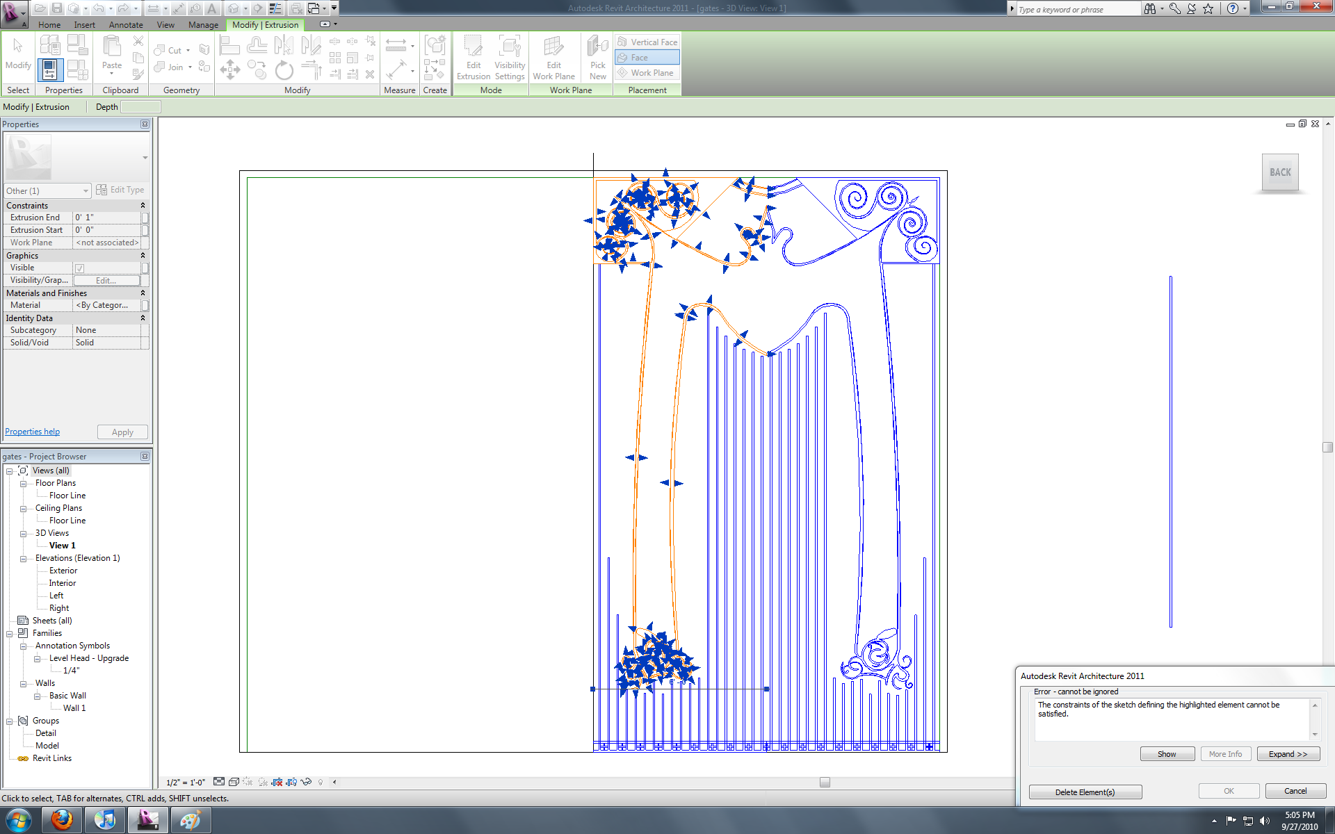

I'm trying to mirror the design i did on the right, but its proving to be a complete pain. I can't get it to mirror and I keep getting the same error message even though I remove all of the constraints i can find. Can anyone help me

Don't mirror the object - edit it and mirror the sketch making sure you don't have any over-lapping lines.

you sir are a freakin genius, thank you
