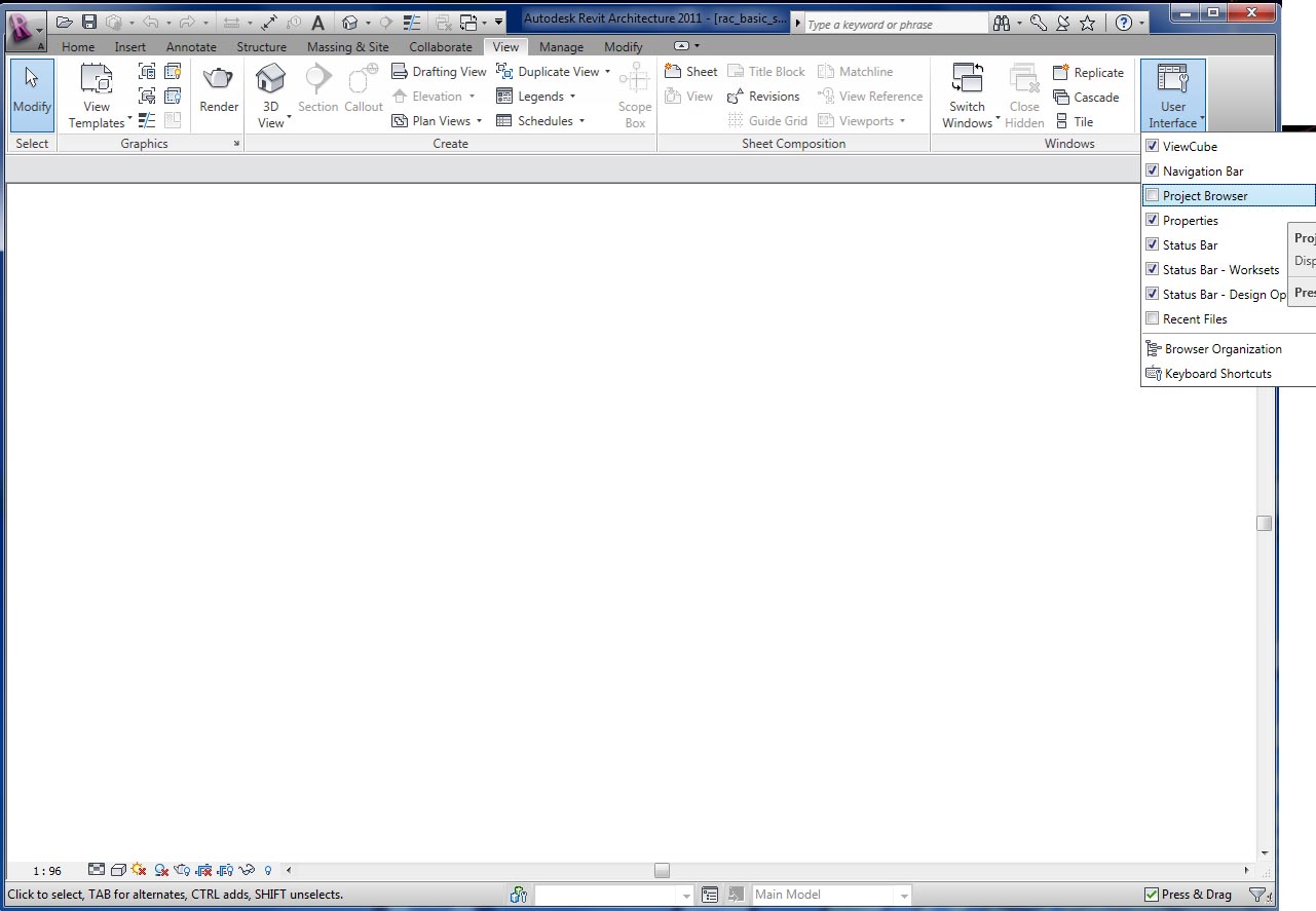

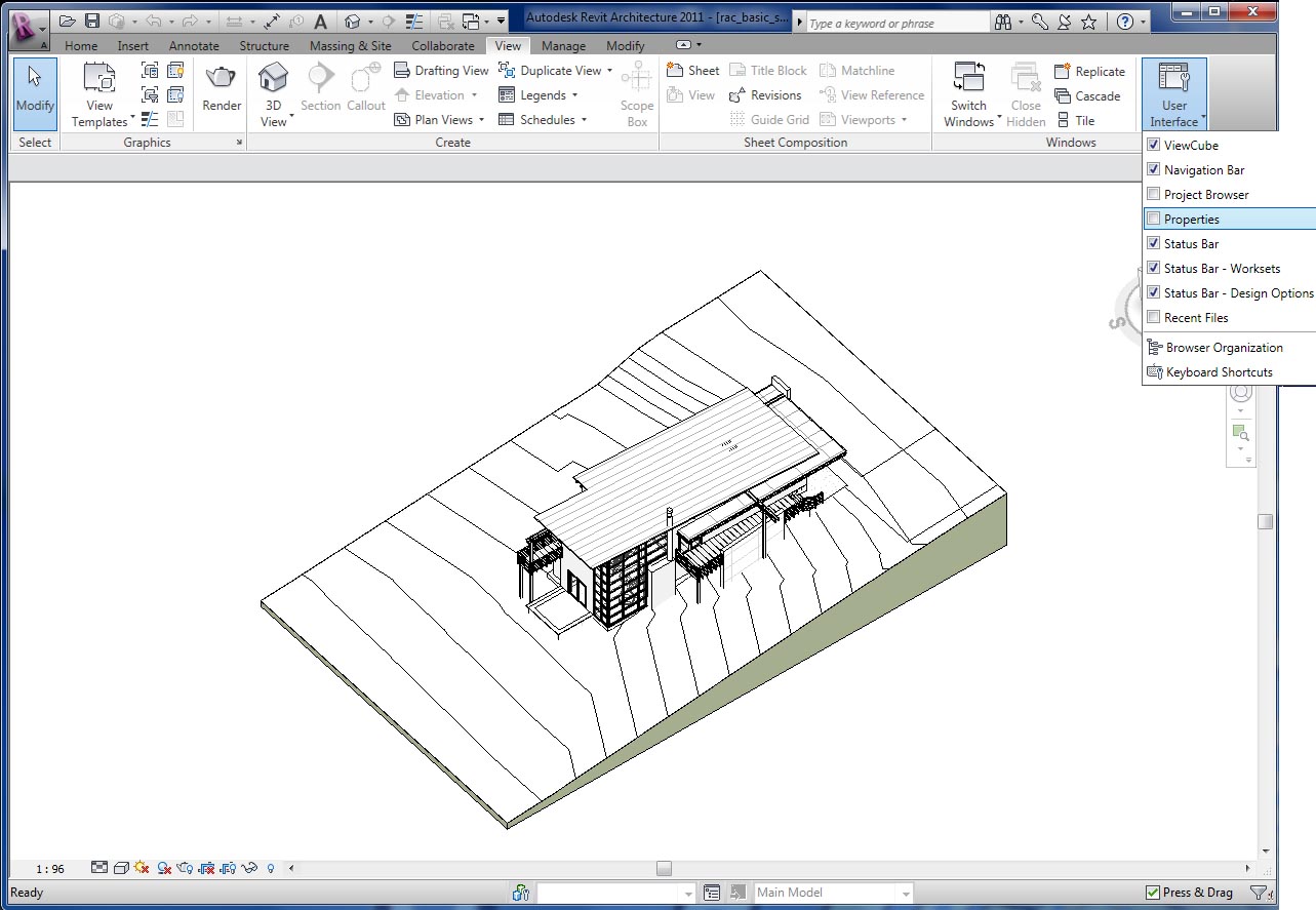

Hello Typhoon,
 I had the same problem, but now, if I activate the Project Browser and the Properties Toolbars, from the >View>User Interface menu, a blank screen appears, the only way of seeing the project is by unchecking the Project Browser and the Properties boxes. (See images)
I tried with the link that you posted, following all the options, but it didn't work.
Help please.
Best regards!

Ok, i forgot one thing, close REVIT and go to that folder and delete the UIState.dat
Windows XP
 C:\Documents and Settings\%username%\Local Settings\Application Data\Autodesk\Revit\\UIState.dat
Windows Vista & Windows 7
 C:\Users\%username%\Appdata\local\Autodesk\Revit\\UIState.dat
After this just run this file i just attached now, click "Executar" then "Sim" then "Ok", it gonna fix the problem.

Thu, Sep 30, 2010 at 1:21:35 PM | User Interface help: Help? please urgent
Gerark
Joined: Tue, Jul 27, 2010
5 Posts
Typhoon you rock!!!
Thank you very much!! I was desperate! about to throw this computer away! hahaha
It worked as magic!
