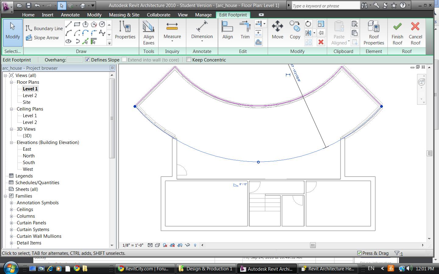

I want to create a shed roof for a curved wall.  It is giving me a error report  "Can't make footprint roof." when I click finish roof.  I was able to create a hipped roof, but when I removed the slope from the other walls and left one sloped side it gives me this error.

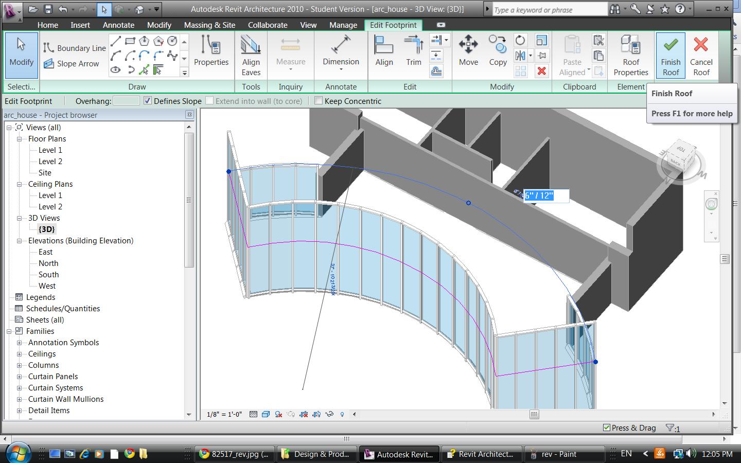

here is the 3d view.

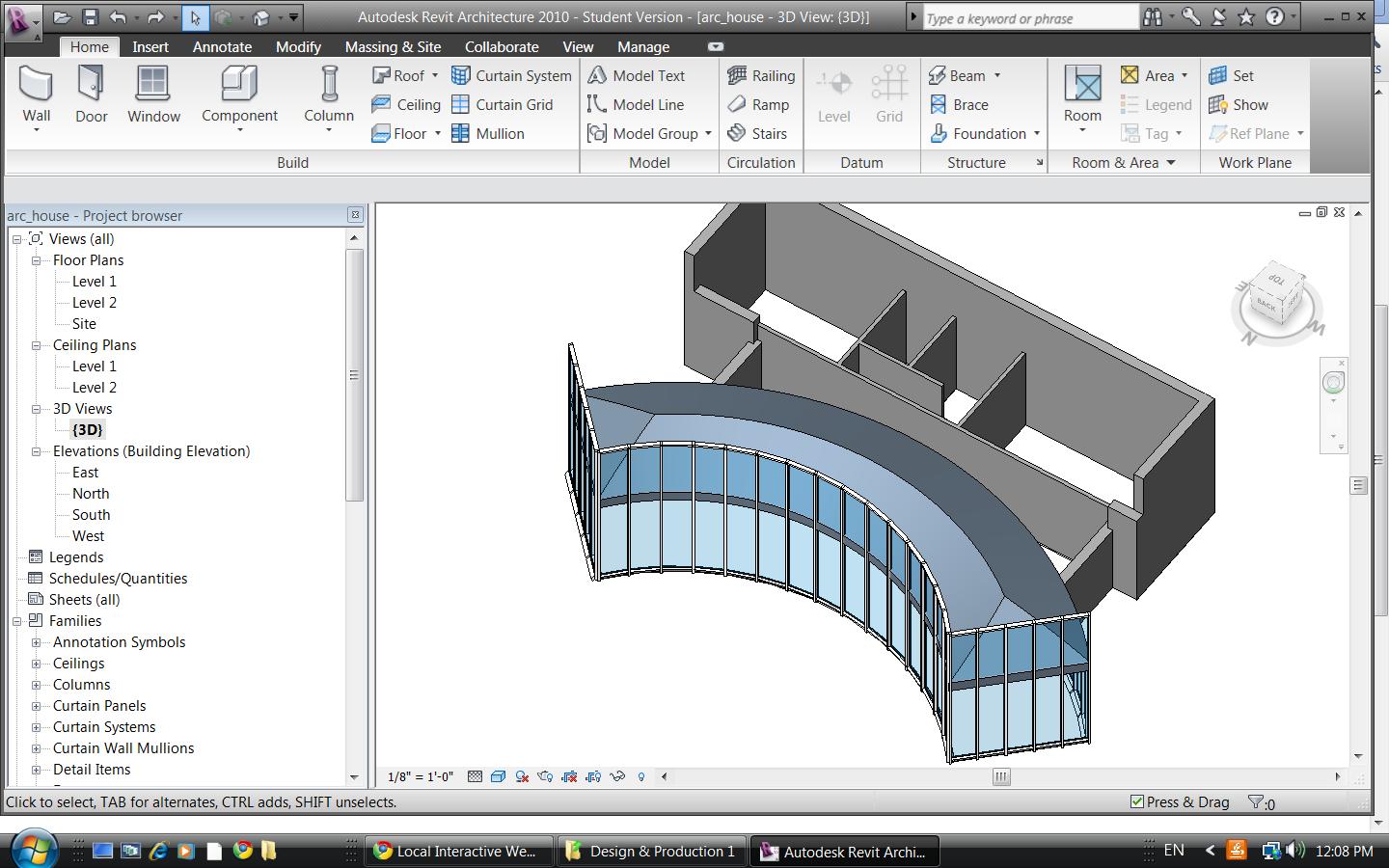

here is the hip that I was able to achieve.

I don't have any problem with that, are you creating the boundaries OR did you use the "pick walls" option?
Fri, Sep 24, 2010 at 3:08:00 PM | unable to create shed roof for curved wall
aiyuguang
Joined: Fri, Sep 24, 2010
4 Posts
I used the pick walls feature, do you suggest creating the boundaries?  How did you do it?
Sat, Sep 25, 2010 at 4:37:32 AM | unable to create shed roof for curved wall
Joined: Tue, May 22, 2007
5921 Posts
4 Stars: 205 Votes
Don't use the "Pick Walls", only draw the "boundaries"
