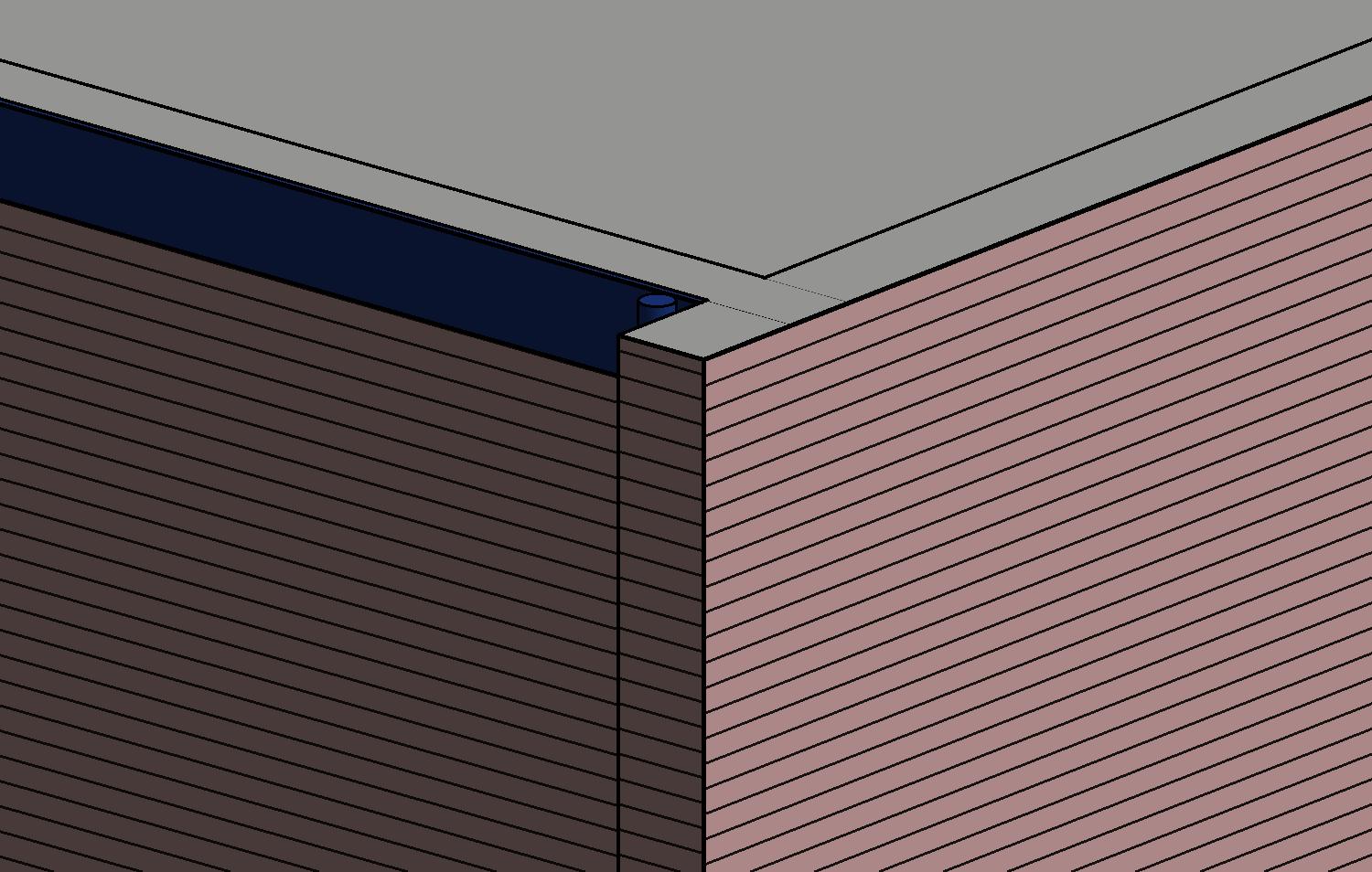

I am using an model pattern, and the pattern can be aligned at walls and roofs.
But sometimes the edges of walls haven't got an pattern so i paint them with the same pattern.
But once this is placed it can't be aligned.
Look at the picture to see that the walls are aligned, but the edge of the wall is not.

i'm sorry, here is the example

I'm not sure that I have run across that but instead of painting the surface, why not set up the exterior face to return at ends of walls.

Sometimes the answer is so simple... Thanks !

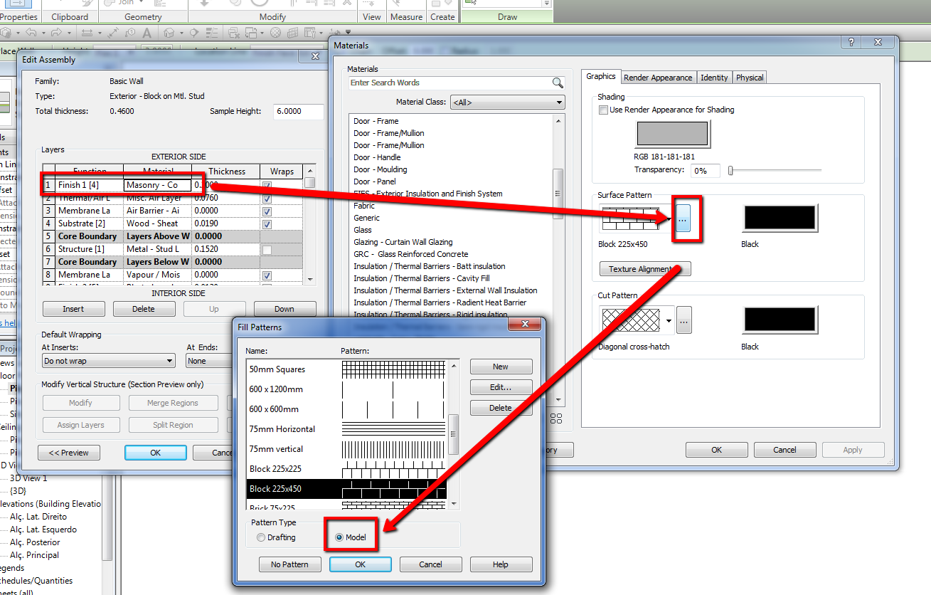

Fri, Jul 22, 2016 at 1:28:22 PM | Align painted surface
ernestoernesto
Joined: Sat, Apr 9, 2011
0 Posts
Hi,
I ran into the same issue recenlty and was able to fix this by simply using the "Align Tool" in an elevation. Hope this helps!
