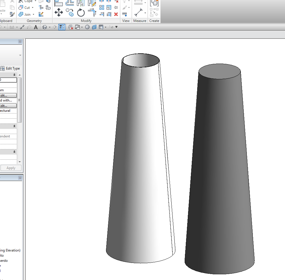

Or you create a "Mass" then apply Walls by face OR use the "Create In-Place" in Wall category then use the Solid "Blend" and a void Blent inside the cone.

How do i create the c one in revit 2011! i cant see the blend tool.

worked it out!

Because you are in "Massing and Site" and not in "In-place", that's why you can't see the "Blend" tool, now in Massing to create a Blend just create a circle in one level then create the other in the other level, select the two circles and click on "Create Form"
