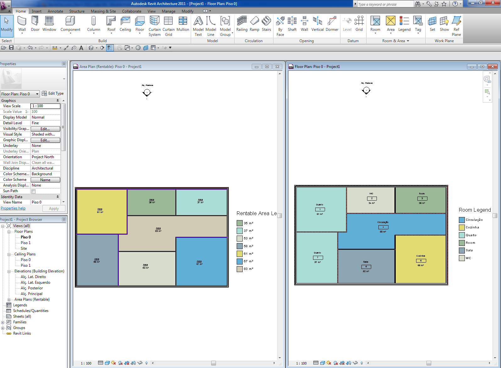

When i make a color fill plan in revit 2011 all my walls disappear. When i make the lines thick and zoom in close then i can see the walls. Is this a graphic card problem??

Wierd, no problem here, did you start a new test project to verify? Is it just in a particular project?
About your graphic card check here: http://www.autodesk.com/us/revit/revit_graphics_hardware_list_June02.html

It is was only i projekts larger than 100mb. It stoped after I updated my driver.
Thanks for the help anyway Smile
