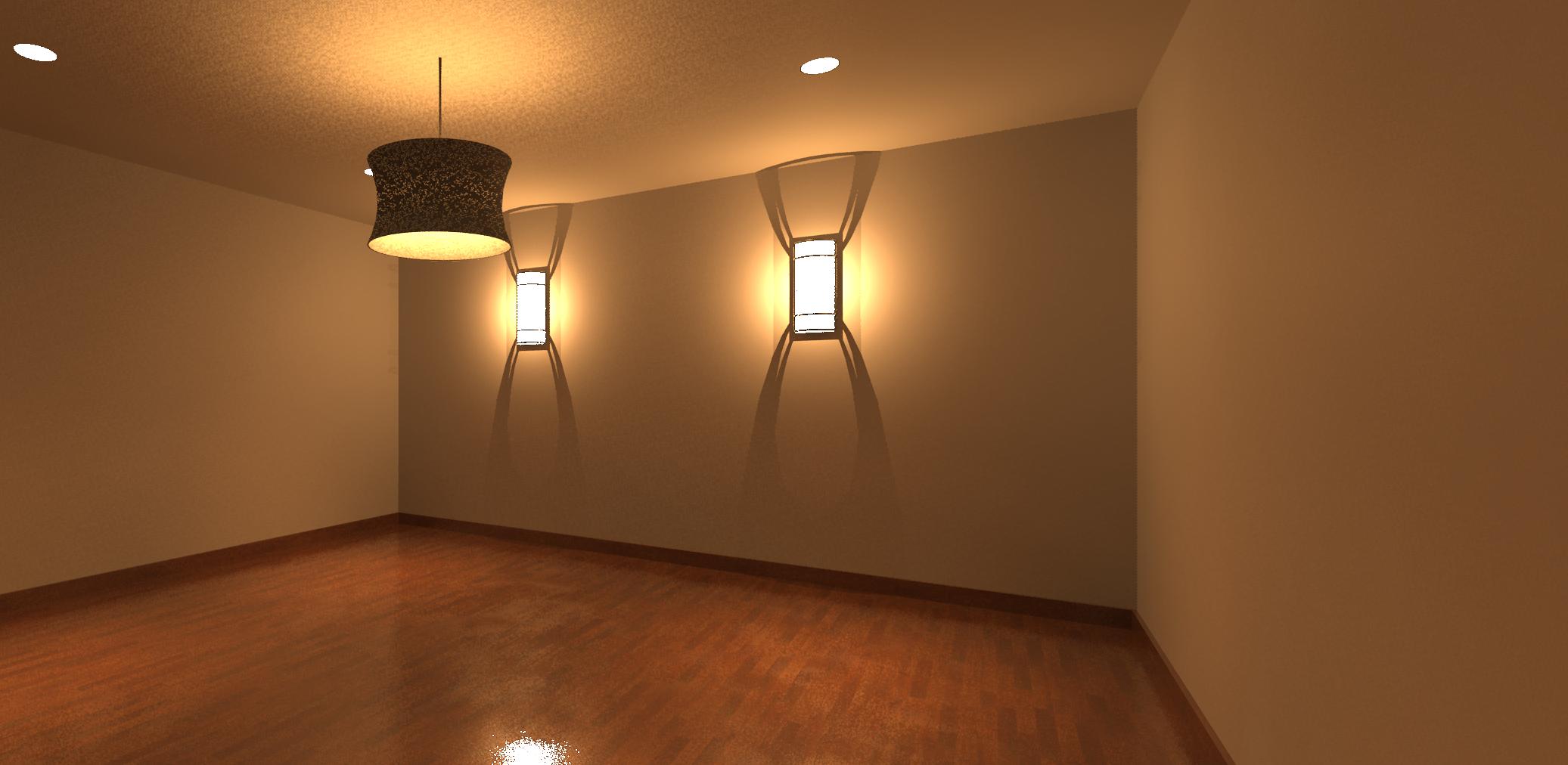

The lighting in the images is difficult to control I cannot get my "swinger a' pendants on or a typical recessed can light. I have check that they are in the right light group and that group is on. Any ideas?
Your help is greatly appreciated!

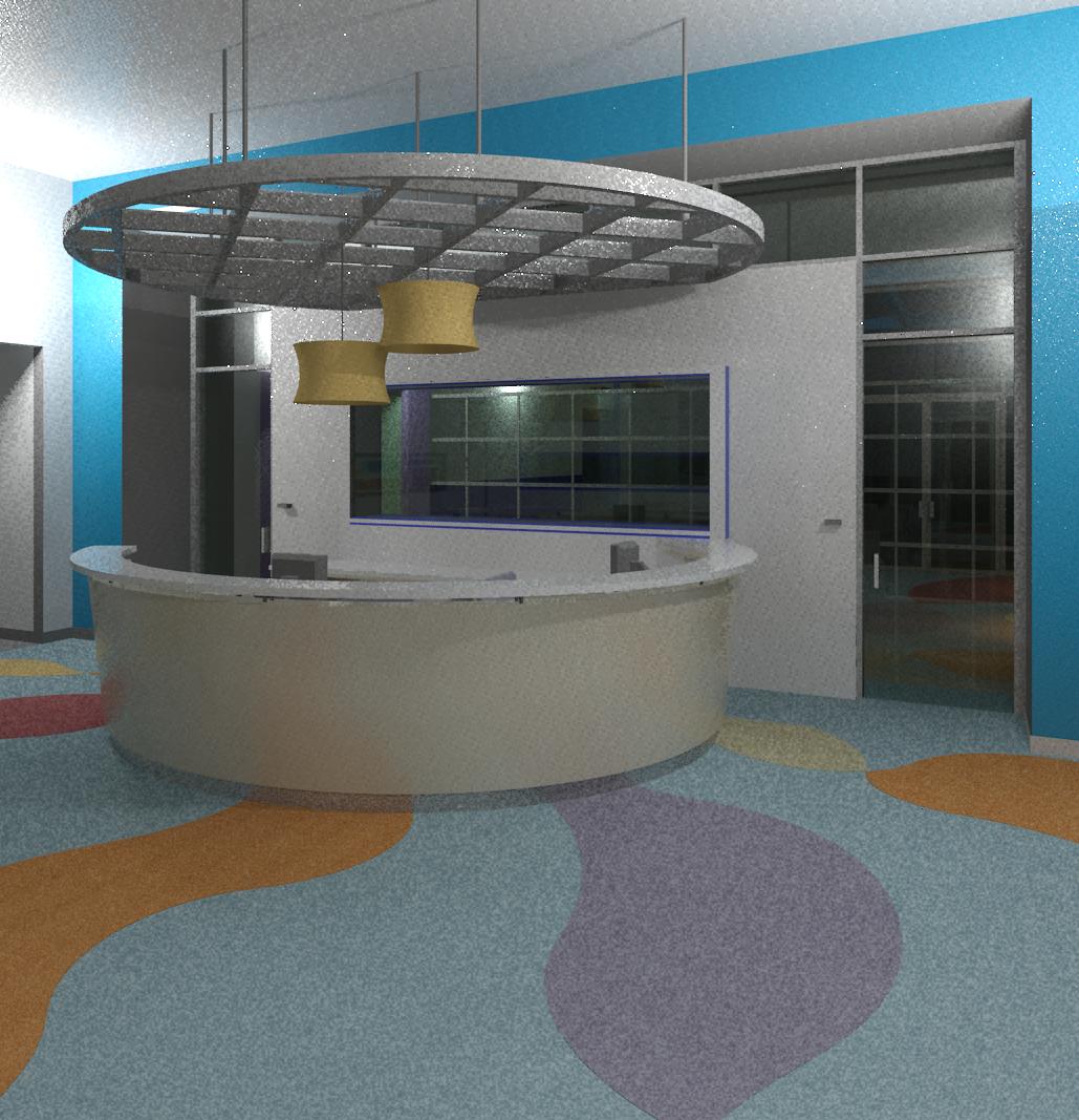

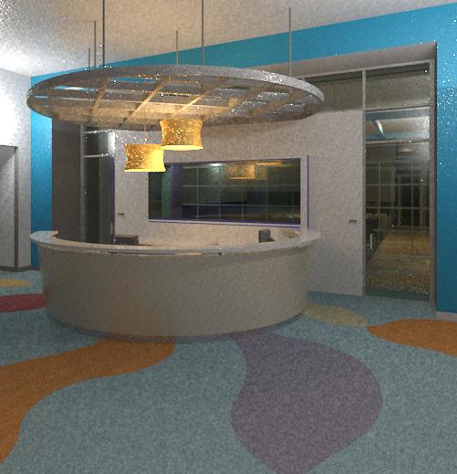

FYI...this is Revit 2011 and only the Swinger A lamp is shown in the attached image...it is the yellow one over the desk.
Thanks-

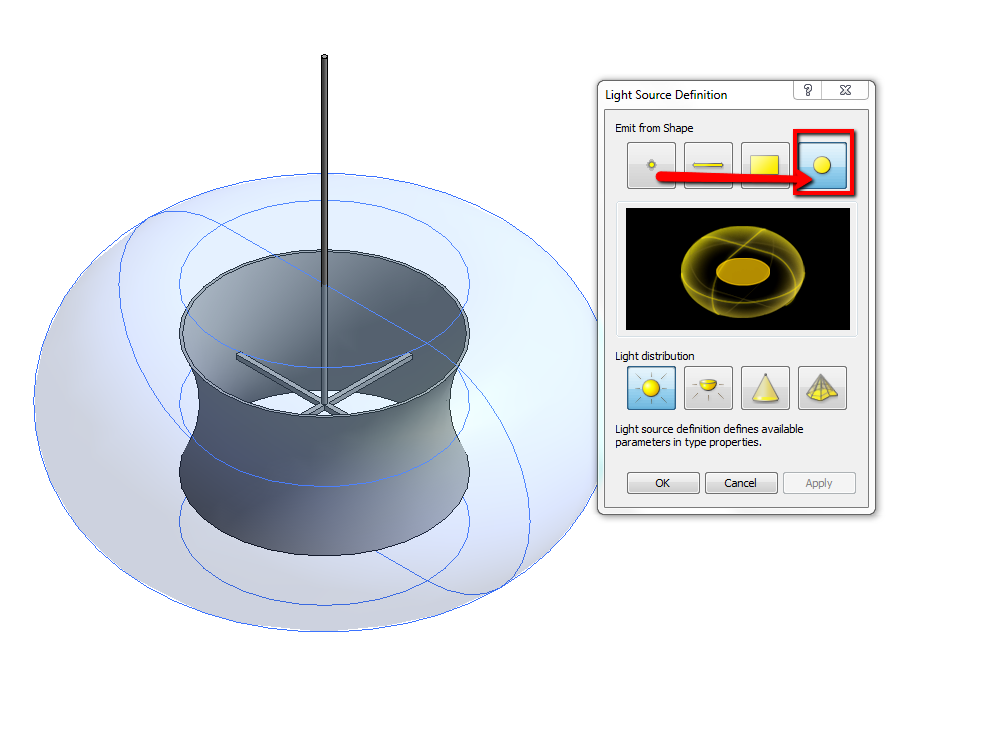

  • spherical light source
  • emit from point
  • 100 watts
  • luminous flux 14854.20
  • 10' distance
  • fabric material but not at bottom where light should shine thru

Simple, just change "emit from point" to "emit from circle"......

Thank you so very much! It worked!
