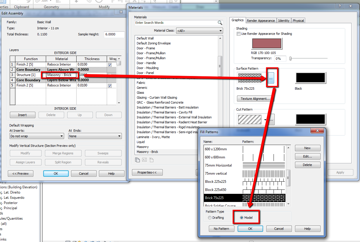

I guess I dont know how to "use a model pattern for the surface pattern". I went in to the wall properties and I see the model/drafting selection for the cut, but not for the surface pattern. Am I looking in the wrong place?
Sun, Sep 12, 2010 at 12:08:05 PM | CMU Block Modules
Joined: Tue, May 22, 2007
5921 Posts
4 Stars: 205 Votes
Maybe this can help you.

Oh...ok. It is already set to model. I see what you mean as far as being able to go to the elevation and using the tab key move the vertical lines where they belong. It would be nice if there was a way to tell Revit to do this automatically instead of going to each and every elevation and doing this, but if not oh well.
