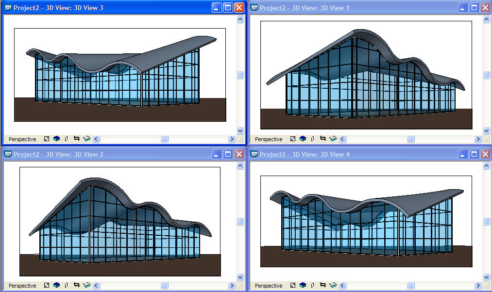

Quite a lot is possible with Revit roofs. The Roof tool by itself or via In-Place Families assigned to the Roof category. Here's an example of the later using the Solid>Blend option. Tensile roofs like those that Birdair makes are probably the hardest to replicate but you can often get a reasonable decent representation for design purposes. You can also import nurb based objects into Revit to use for such forms.

thank you guys very much ...I now I understand how even if I can't yet control the result Smile.the photos you've attached are exactly what I was talking about.I have a project at school related to this topic ( something involving a skating platform )...soon as I finish it I'm gonna post some images Smile
