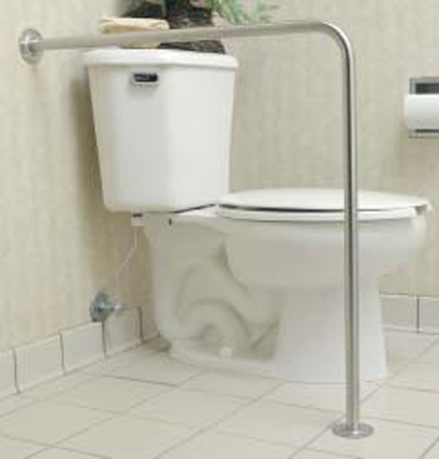

Does anyone have a wall to floor grab bar compliant with ADA requirements? As for a stand-alone toilet?

you mean a vertical grab bar? I have never seen anything in ADA about a grab bar being attached to the floor for a toilet stall, except maybe in a strip club. Smile

tHE GRAB BAR WOULD NOT BE IN A STALL, IT'S MOSTLY USED IN RESIDENTIAL USES. BUT HERE IS AN EXAMPLE. SEE PICTURE.

If you looked in the downloads and didn't find it, I would just build my own.  Grab bars are a good place to learn how to build a family.  Really just a sweep.  Then you can add extrusions at the end for the escutcheons or just short sweeps.

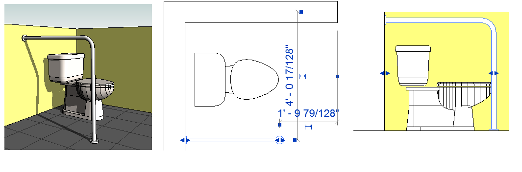

Ok here's the new family and image.
It is a generic 'floor based' family ie: you need a floor.
As shown in the image I made it so you can stretch the length in plan and elevation by the shape handles. Otherwise there are 3 parameters for length, height and material.

Thank you for posting the family! I really appreciate it. One little problem though...can I somehow open it in revit 2009? I think the one you made is in a later version.

Looks like you are going to have to wait for the videos and built it yourself. Videos should be done today.

Ok, here are the videos to create the grab bar family.
