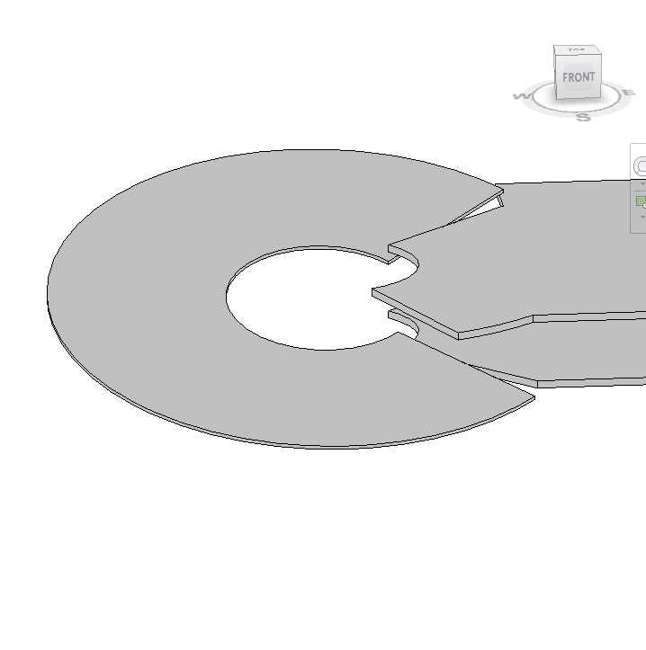

I know this is a common topic on revit and maybe it´s all been seen about this subjet.
My issue is that I have a parking building with some ramps that I allready made with the ramp tool... When I started my floor plan I realized that you cannot tag an spot slope on a made-with-ramp-object (I don't know why it´s not possible even on revit 2011, I think that every object on revit should be able to be tagged... whislist!) and I decided to change my ramps to curved and sloped floors.

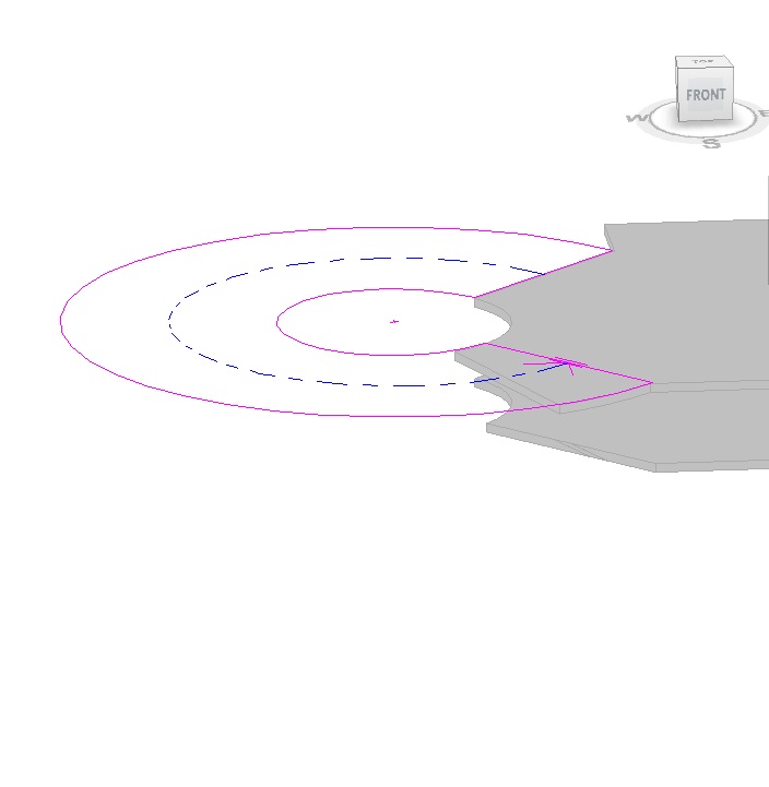

Now I just cannot adjust the ramp with floors, my levels are fine but the way the floor is working is wrong. I´m uploading two images to explain the way is working and I hope that is only a check mark on a property and not the imposibility of revit to make floors on ramps.
Tnks!

Use the Modify Sub elements tools ?
Have a look at this Parkade video.

Thanks. I just did It with subelements, but the ramp-made-with-floor should be more automated, because the curvature has not a constant slope thanks to the external ratio and the internal. But it will work just fine for know.  Thanks a lot.
