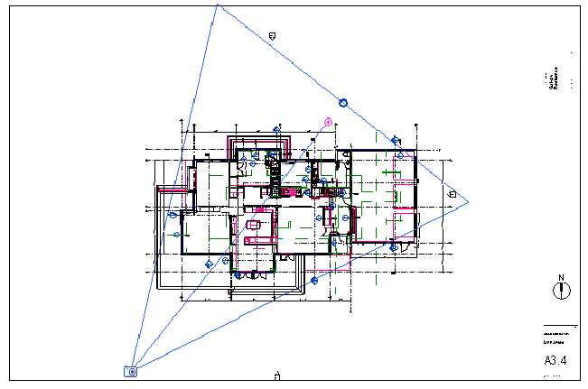

is there a way to keep the camera visiable on the floor plans?

Not that I know of but an interesting concept.
As in 'show camera' and 'leave camera visible in view'.
Create a dummy annotation tag and place it in plan but as you probably know it will not be associated to the actual camera view as it moves and you cannot use the 'reference other view' tool either like sections and elevations can do.

"As in 'show camera' and 'leave camera visible in view'."
yes exactily, normally it wouldn't be an issue and we have dumb annotations that show the location of the camera but as you say they don't move and rotate with the camera
the nit whit city counsil and some property owners are questioning our 3d perspective views that we have presented
they have seen how a smart elevation tag works and can get over the fact that the camera's don't work the same (i know they are morons) but it is part of the "find something, anything to deny the project" mentality that they have

Then I would use the 'show camera' and do a screen capture (snagit or alt+prtsc), then paste that to a graphics app. and save it as a jpg, then re-insert it into a drafting view and place it on a sheet.
DONE.
See attachment.
