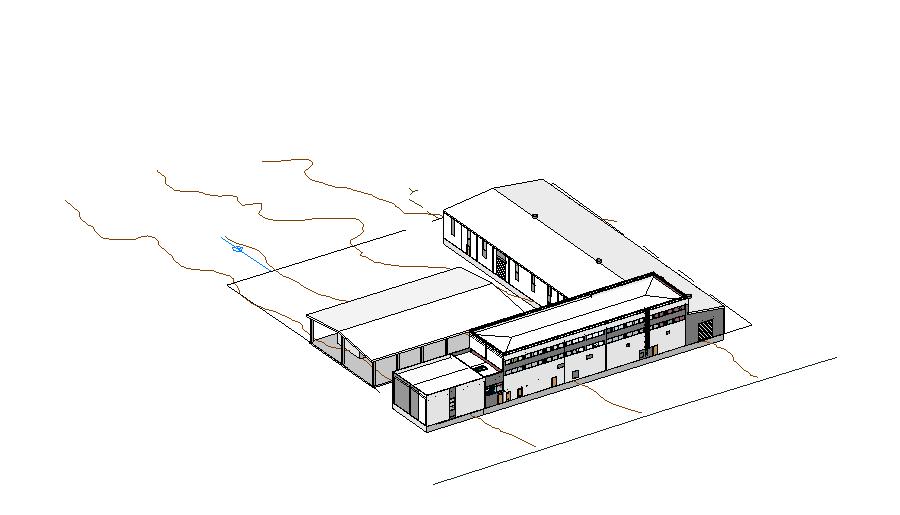

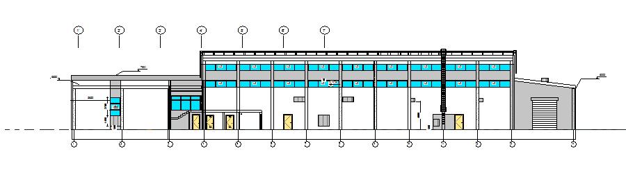

Hello,
For some reason elements that are adjacent to a wall are visible in the elevation view. Those elements are on the opposite side of the wall and shouldn't be visible. This goes for everything stairs, columns, furniture... It's the same is it hidden lines or shaded with edges. in the 3dview everything's OK.
I was working on revit 2009, tried opening it with 2011- same thing..
Please help, I have no idea how to solve this and the dead line draws close...

It looks like you have the "Elevation Mark" inside the building, in plan view check where is that Elevation mark, then drag that to the outside.

Thank You Typhoon for the reply but that's not it. I was trying to solve this for 2-3 days (not consistent head bashing of course) and just after posting this I've found the problem:there was a HUGE dwg imported just by deleting it everything jumps back to normal.. still consider it a bug, but at least troubles for know are over =)Also this messed up the shaded view colors.I apologize to the community for this "spam"
