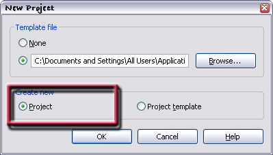

No,
Save everything you have done so far as an rte file. Then, under the applications menu pick on New > Project.
Then, just browse to the rte file you just saved and then tell it to open as a project.
See the attached image

Ohh, got it. Thank you, thank you!
