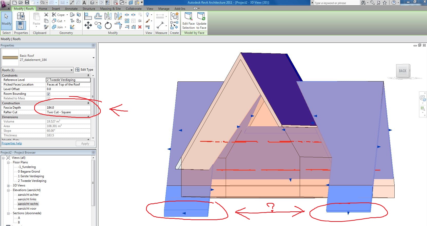

Hello,
I have this problem, I select a roof, change the rafter cut, and set fascia depth.Works most of the time, but this time the rafter is different on the same roof! See the image. How is this possible?
Thanks!

what method did you use to create the roof?  If by footprint, I would edit it and check the line segment that isn't cooperating and see if its properties are different--such as if it has a specific, specified height offset.  It also matters if, when you make a footprint, you use "pick walls" as your sketch tool, or if you just hand-draw the footprint.  Using a combination of sketch tools can sabotage you.

Okay thanks.
I created this roof with "roof by face". I use msses who has specific properties of our building system, so that each roof is on the right place. I deleted this roof, an re-created it, and everything was fine... Smile
Thanks for the help though!
 Other question: The 2 roofs are in different directions. Is there a way to align the eaves, like there is when made by footprint?
