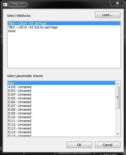

First, right click on Sheets (all) and create new sheet. It will show you to select titleblocks. Before you click OK, just take a look under Select placeholder sheets. You can see your already create loaded Sheet name and number that you can still use by clicking or selecting which on the list is what you need instead of New. Hope this will help you and others.
